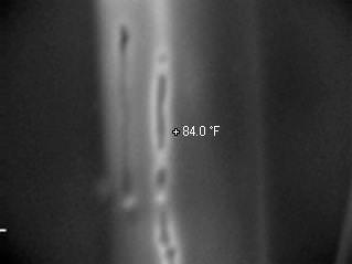

Originally posted by Chris Bernhardt
Whats the resolution on the fluke? I have tried to look at sugar ants but they are too small. I have concluded it's probably impossible to see moving insects with the Bcam.
The other day I found some carpenter ant evidence up in the attic of this house adjacent to the garage. When I scanned the walls of the garage in the area I found this curious warm spot. It was colder then crap that day and I didn't find any reflections or charges that might be causing it. I came back the next day to look at the spot again and it was gone.
Size isn't the prob, the ants do not leave a heat signature so any IR camera will not see them, especially the Bcam ,don't like it-sorry:(

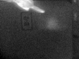

Carpenter ants will not give off heat, sometimes on a good day with the right camera you can pick up the air trapped in the galleries, but no ants. If it was cold you might have picked up a critter seeking refuge for the weather and when you went back they had left - maybe.
Image Insert:
6.26 KB
Termite gallery in stud.
Image Insert:
10.78 KB
Rodent in wall.
