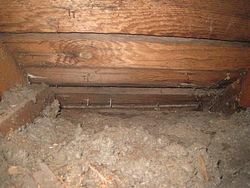

Chris Bernhardt Posted March 26, 2008 Report Share Posted March 26, 2008 I found another roof leak that I would have missed. Image Insert: 72.58 KB Image Insert: 73.2 KB Dead valley drains off to the right side of the house (chimney side) Image Insert: 72.94 KB Comes around the corner. Trim & fasica has decay. Image Insert: 75.14 KB Stains, streaking and blistered paint on eave. Image Insert: 61.82 KB View of bedroom wall behind path of runoff. Image Insert: 28.84 KB What IR picked up on wall. Hit it with my moisture meter and Bingo! Image Insert: 27.94 KB What IR saw above this area in the attic. Image Insert: 74.55 KB Forced myself out to the corner to take a look and sure enough the plywood roof deck over the skip sheathing is darkened and there are stains on the top plate. Now, I say I would have missed it. That doesn't mean a prudent inspector would have. I showed this to Jim Katen and Jim explained that he takes the time to consider how water is running off the building and where spaces are before he gets into the house, then pays attention to those areas. What IR is teaching me to do is what Jim already does without an IR camera. Chris, Oregon Link to comment Share on other sites More sharing options...
Chris Bernhardt Posted March 26, 2008 Author Report Share Posted March 26, 2008 Now, let me add that I was not smart enough to consider that the roof might be leaking there. Nor did I purposefully target the area in the interior. At some point in each inspection I will stop the visual inspection and start scanning the house with my IR cam. It was on passing thru the bedroom that I picked up the anomaly and then checked it with my moisture meter then headed to the attic. Now when I got into the attic I decided to take a look at what it looked like on IR, which I normally don't do. Since it was indicating strongly, I forced myself out to the apex to take an up close look, again which I normally don't do. Why? because it hurts balancing yourself on knees and elbows on the tops of 2"x while holding flashlights and cameras etc. And they say that inspecting is not a physically demanding job. Chris, Oregon Link to comment Share on other sites More sharing options...
