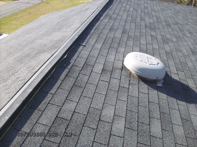

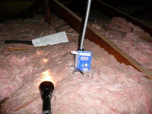

Phillip Posted March 26, 2008 Report Posted March 26, 2008 Here lately I been seeing where some one has been coming in and adding power vents close to the ridge vent. What a waste. This hurts more than it helps. Image Insert: 146.14 KB Image Insert: 145.53 KB

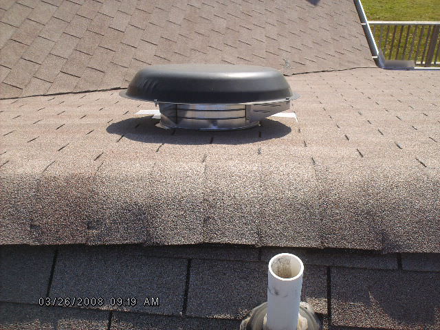

Mark P Posted March 31, 2008 Report Posted March 31, 2008 Here is one from today, where they did not even bother to hook power up to it. I'm sure it has been like that since the roof was installed in 2006. Image Insert: 55.96 KB[/size=1
Sodapop Posted April 3, 2008 Report Posted April 3, 2008 Originally posted by AHIS Here is one from today, where they did not even bother to hook power up to it. I'm sure it has been like that since the roof was installed in 2006. Image Insert: 55.96 KB[/size=1 They couldn't afford an electrician after having a new roof put on.
