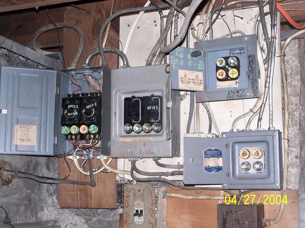

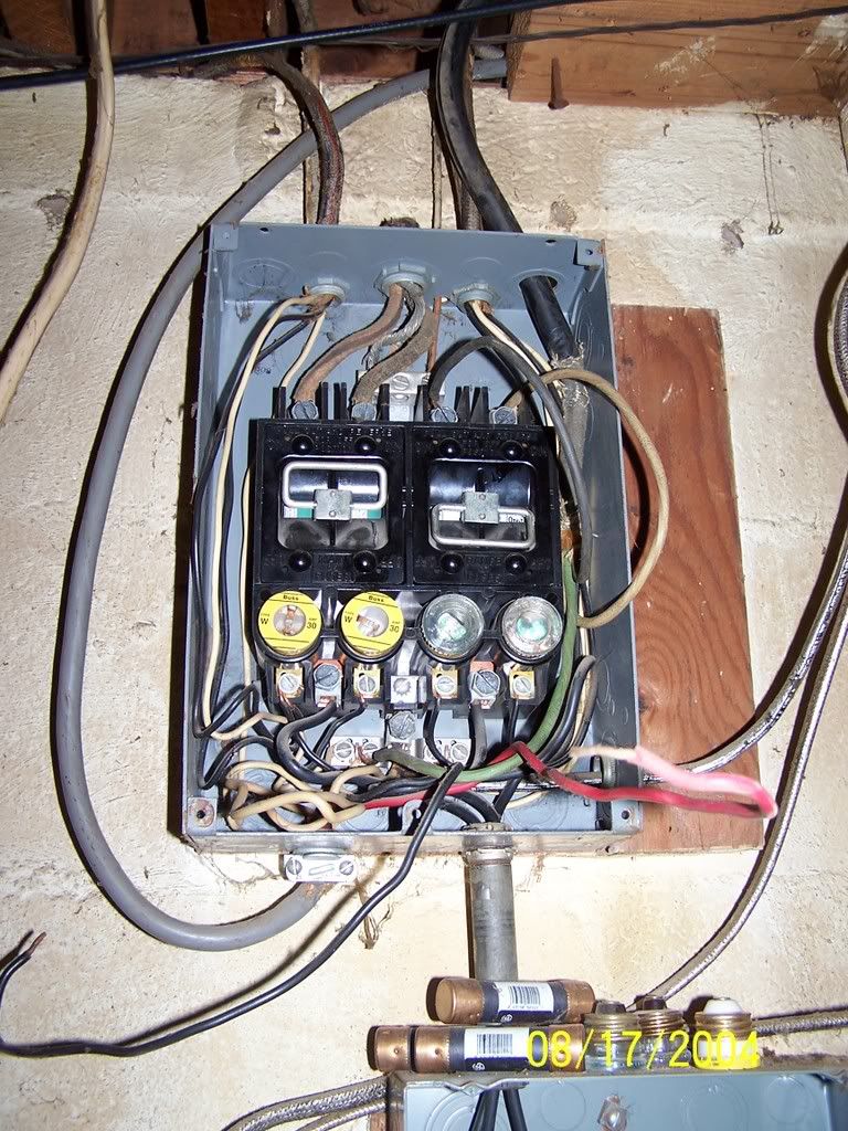

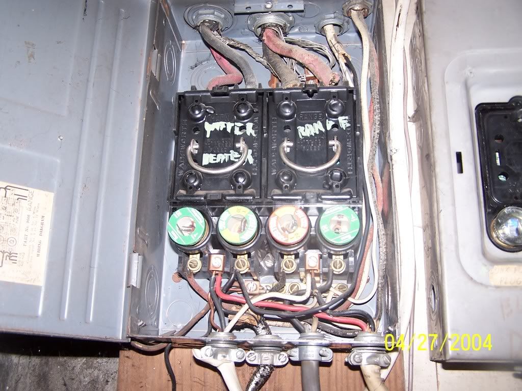

Sodapop Posted March 26, 2008 Report Share Posted March 26, 2008 These photos any help? [ Link to comment Share on other sites More sharing options...
hausdok Posted March 26, 2008 Report Share Posted March 26, 2008 Ye Gads! That's downright scary! OT - OF!!! M. Link to comment Share on other sites More sharing options...
Sodapop Posted March 27, 2008 Report Share Posted March 27, 2008 Originally posted by hausdok Ye Gads! That's downright scary! OT - OF!!! M. I did an estimate on this for a service upgrade for a real estate agent. Sad thing is, the prospective homeowner thought it was OK. They didn't want an upgrade. Good luck with homeowner's insurance. Link to comment Share on other sites More sharing options...
