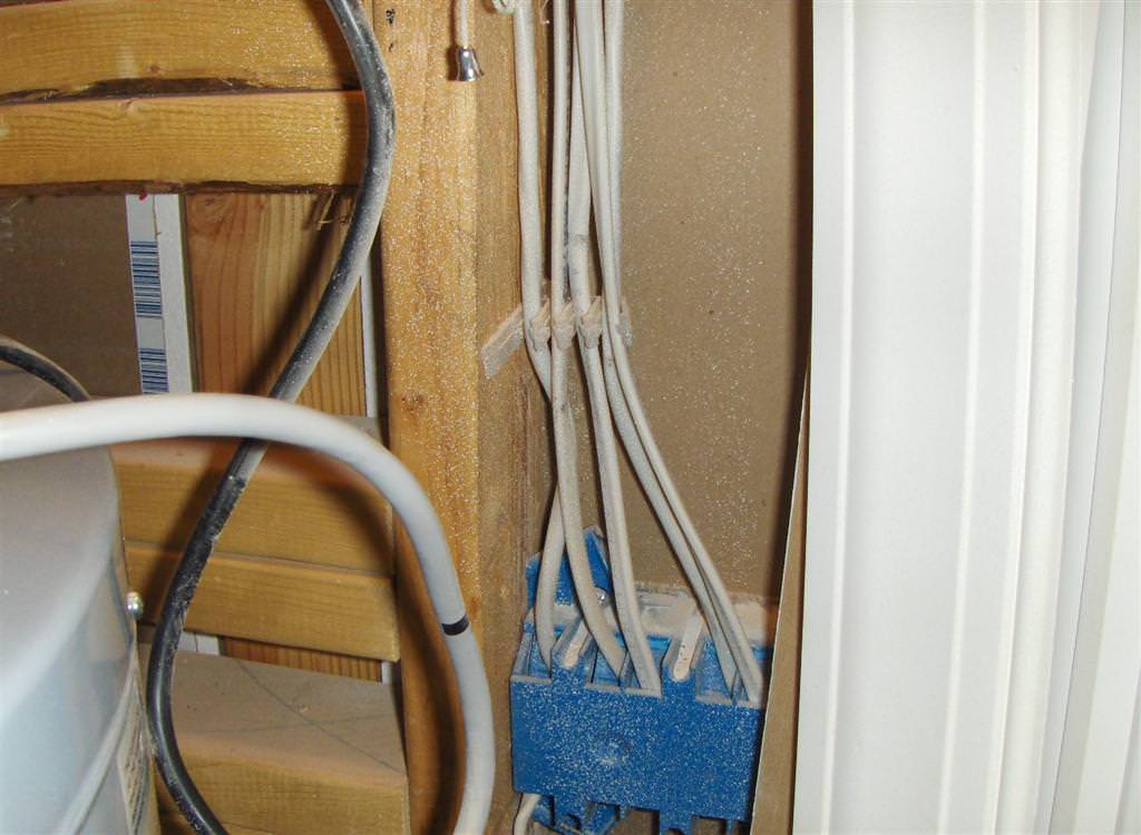

John Dirks Jr Posted March 21, 2008 Report Share Posted March 21, 2008 This is the only thing securing these wires within 1 foot of the box. Is this acceptable or should there be regular wire staples here? I have not seen this until today. Image Insert: 111.99 KB Link to comment Share on other sites More sharing options...
Sodapop Posted March 22, 2008 Report Share Posted March 22, 2008 Have been looking at this forum for a few days and have finally registered. First post. The cable supports in your picture I believe are the 3M brand. Other manufacturers produce them as well. I have have used these before and they are a labor saver. The cable clamp helps to meet NEC 2008 334.30 Securing and Supporting NM Cable. The basis for the cable clamp is also to meet the 1 1/4" requirement in NEC 2008 300.4(D) Sometimes it is almost impossible to meet these requirements, but these clamps are code compliant. Will try to post a link when I find one. Link to comment Share on other sites More sharing options...
