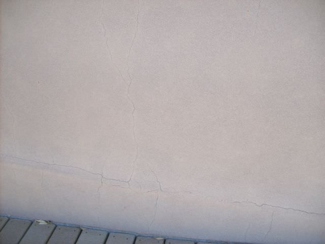

mridgeelk Posted March 19, 2008 Report Posted March 19, 2008 This home has R-Panels for exterior walls with conventional stucco. The horizontal crack is where the walls meet the slab which has in-floor hydronic heat. This home is about 6500' above sealevel with temperature extremes 100 to -30 F. The south and west faces are as usual the worst. The amount of cracking seems high. Is this typical of R-Panels and stucco? Image Insert: 360.15 KB
hausdok Posted March 20, 2008 Report Posted March 20, 2008 Hi, If you're talking about SIPs walls, they're definitely wrong. The slab and the wall panels will move at different rates in response to temp/humidity changes. There needed to be a termination bead with weeps above the edge of that slab, as well as accessory and expansion joints at appropriate locations. Need help with getting some authorative substantiation? - Contact Mark Fowler at the Northwest Wall & Ceiling Burea (http://www.nwcb.org). ONE TEAM - ONE FIGHT!!! Mike Mike
