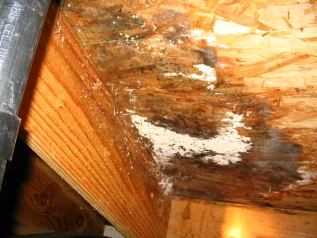

Chad Fabry Posted November 9, 2008 Report Share Posted November 9, 2008 Mike, I disagree. I've seen tons of damage in attics resulting from bath fans that are vented to the space. Mold, delaminated plywood and saturated insulation below condensation points. The fact is, it's prohibited by code and it's a win-win situation when you alert your client to the condition. Common practice is frequently on the wrong side of common sense. Link to comment Share on other sites More sharing options...

SWagar Posted November 10, 2008 Report Share Posted November 10, 2008 Image Insert: 150.7 KB Here is what can happen when the "fart fan" is not directed to the exterior. This growth on the roof sheathing was directly under the exhaust fan duct. You cannot see the duct in the photo but it was below this area by about 12 inches. Link to comment Share on other sites More sharing options...
