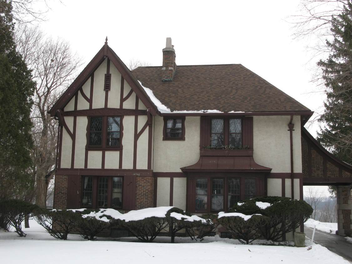

dtontarski Posted March 16, 2008 Report Posted March 16, 2008 I had the opportunity to inspect a fine 1930 Tudorbethan (Tudor Revival) the other day which has a relatively new boiler being used to supply the home's original steam radiators. Everything seems to be working fine. My client (the buyer) has stipulated that they require the buried oil tank to be removed and the boiler be converted to natural gas. They asked if I could make some specific recommendations regarding guidelines for tank removal in my report. They want to make sure this is done right and that they don't face any environmental liabilities in the future. Any guidance on this would be appreciated. (also any related info on oil to gas conversion would be appreciated if issues are known) Thanks! Dave Tontarski Advance Home Awareness Download Attachment: Molly & Michael 001.jpg 140.11 KB
