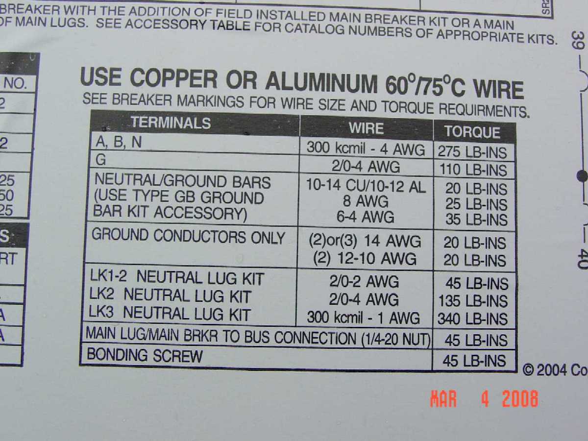

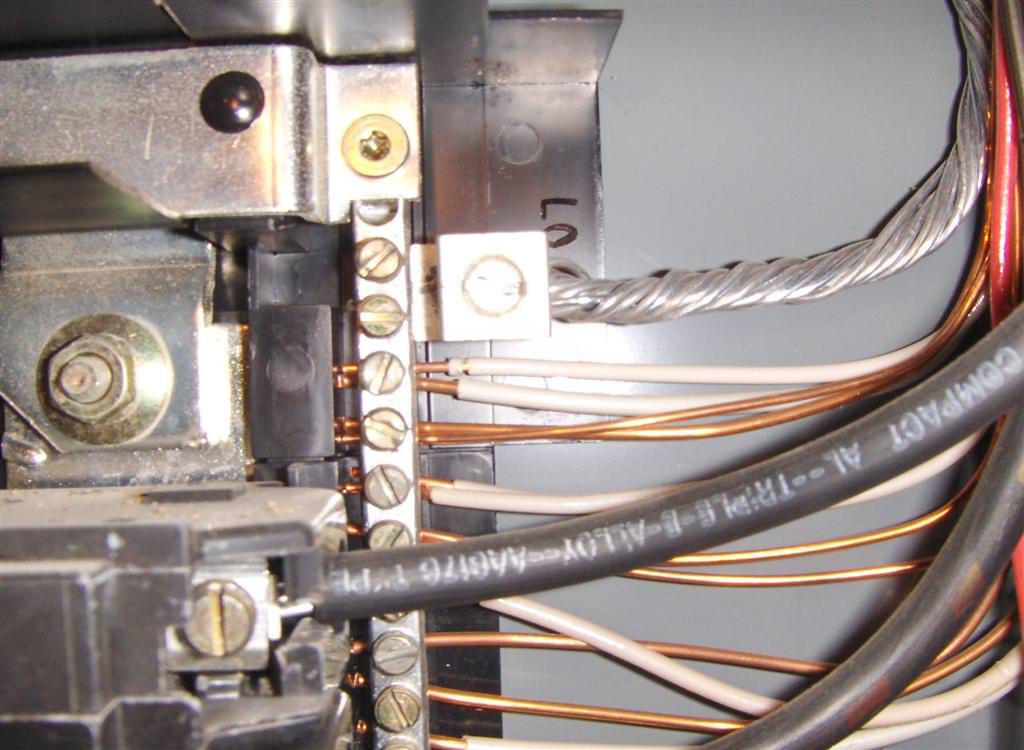

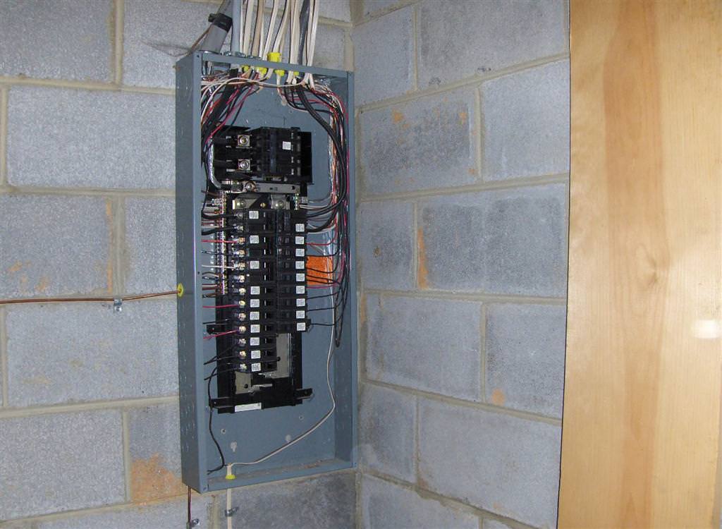

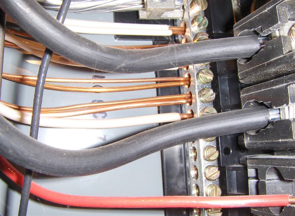

John Dirks Jr Posted March 14, 2008 Report Share Posted March 14, 2008 I have seen panels that allow two conductors to share a terminal if they are the same size. In this panel there are several terminals that share conductors of different sizes. Is this ever allowed? It is the main panel so I figure the neutrals and grounds on the same bus are not a problem as they shoud be bonded in the main anyway. I dont know why the shared terminals anyway as there were plenty of empty ones. Image Insert: 117.9 KB Image Insert: 141.62 KB Image Insert: 128.66 KB What do you think about the panel being stuffed in te corner? Image Insert: 120.48 KB Link to comment Share on other sites More sharing options...
Brian G Posted March 14, 2008 Report Share Posted March 14, 2008 Originally posted by AHI I have seen panels that allow two conductors to share a terminal if they are the same size. In this panel there are several terminals that share conductors of different sizes. Is this ever allowed? No. It is the main panel so I figure the neutrals and grounds on the same bus are not a problem as they shoud be bonded in the main anyway. Correct, but the neutrals should be one per terminal unless the wiring instructions specifically allow two, which I don't think you'll ever see on a new panel. Note the specific language in this Seimens label. Image Insert: 115.75 KB I dont know why the shared terminals anyway as there were plenty of empty ones. Other than laziness and habit, you got me. [?] Brian G. That's the Way Old Man Jones Did It, So That's The Way I Do It [^] Link to comment Share on other sites More sharing options...
Jim Katen Posted March 14, 2008 Report Share Posted March 14, 2008 The doubled-up neutrals are wrong because you're supposed to only have one neutral per terminal. The doubled up grounding wires might be wrong if there are two sizes under the same screw. Read the schematic on the panel. The panel in the corner is fine. - Jim Katen, Oregon Link to comment Share on other sites More sharing options...

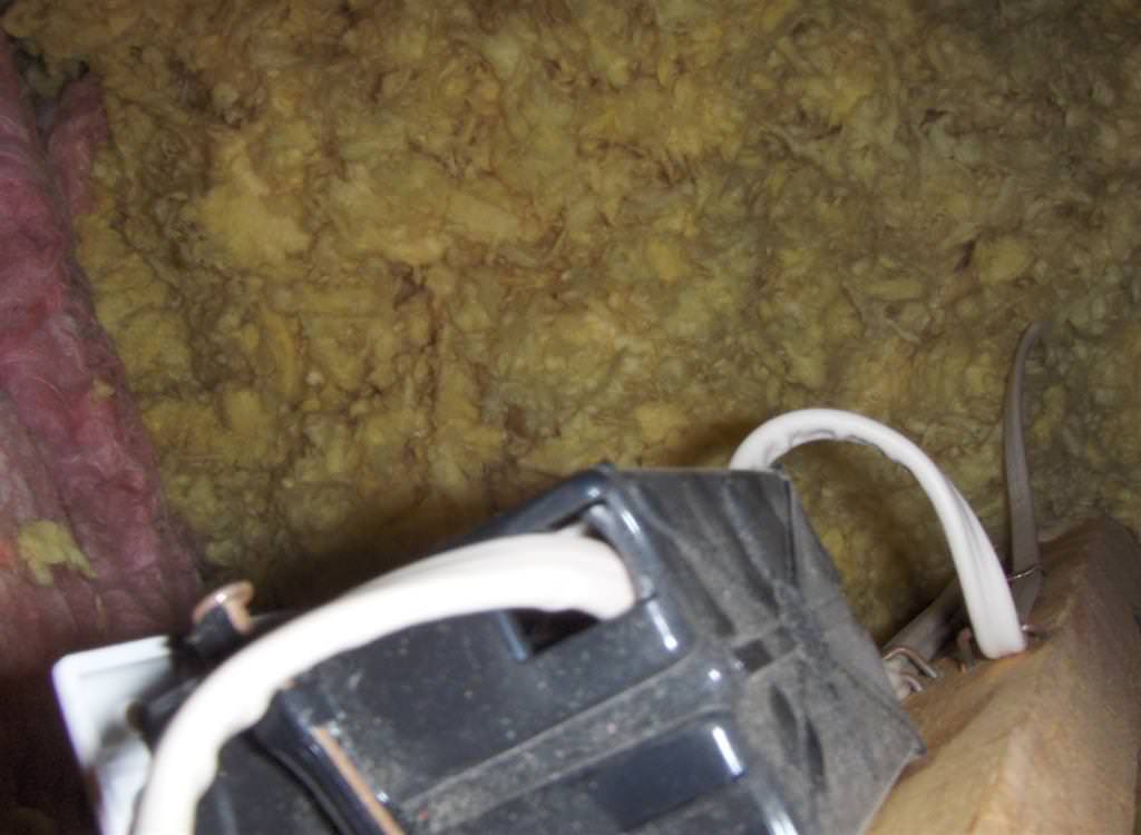

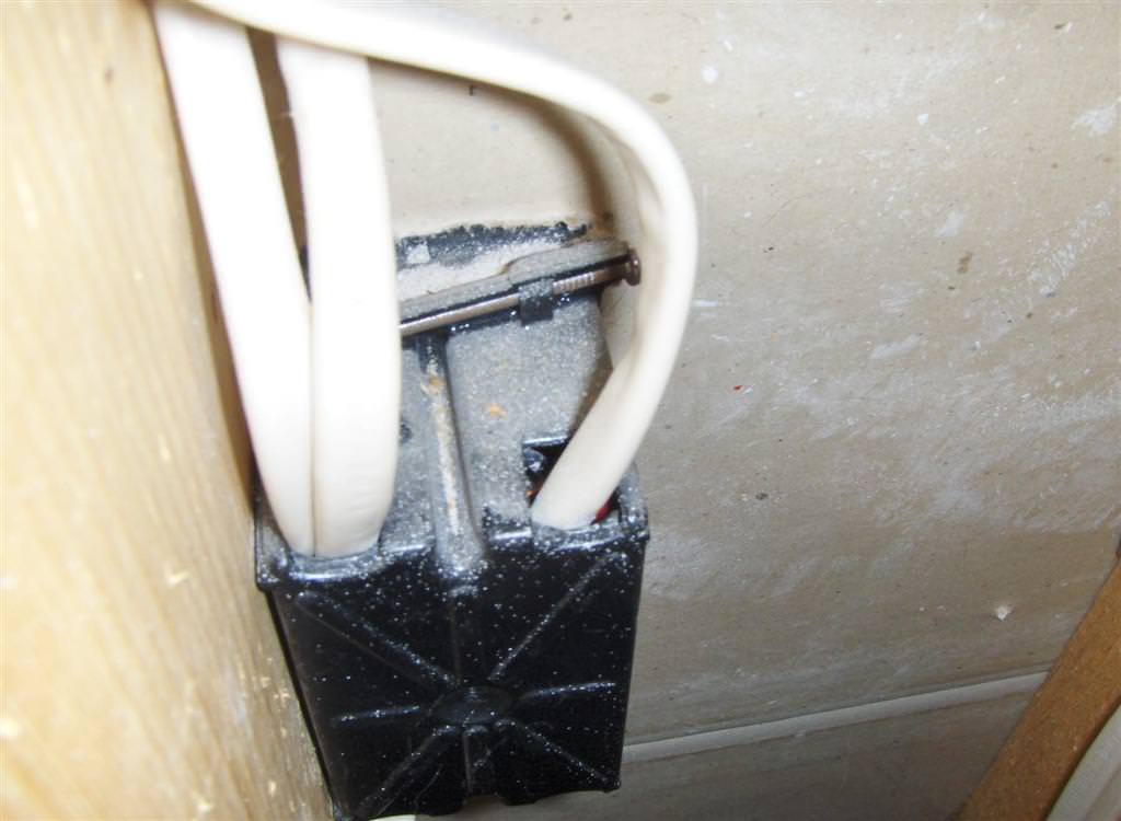

John Dirks Jr Posted March 14, 2008 Author Report Share Posted March 14, 2008 Thanks Brian. Bring on the electrician. Another thing, this place had all these new work plastic boxes and the those little flip type openings were broken completely off. Because of this I saw no effective system of securing the wire connections from being tugged. I suppose I should call this out as well? Image Insert: 93.94 KB Image Insert: 86.44 KB Link to comment Share on other sites More sharing options...
Jim Katen Posted March 14, 2008 Report Share Posted March 14, 2008 Originally posted by AHI Thanks Brian. Bring on the electrician. Another thing, this place had all these new work plastic boxes and the those little flip type openings were broken completely off. Because of this I saw no effective system of securing the wire connections from being tugged. I suppose I should call this out as well? As long as the cables are secured within 12" of the box, I wouldn't worry about it. -Jim Katen, Oregon Link to comment Share on other sites More sharing options...

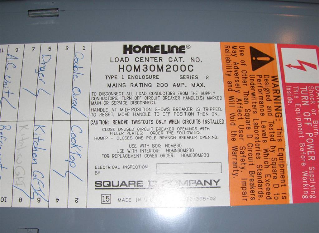

John Dirks Jr Posted March 14, 2008 Author Report Share Posted March 14, 2008 Jim, There was no language anywhere on the panel that mentioned anything about doubling up on terminals. You can see in the photos that they are doubled with different sizes. Link to comment Share on other sites More sharing options...
Jim Katen Posted March 14, 2008 Report Share Posted March 14, 2008 Originally posted by AHI Jim, There was no language anywhere on the panel that mentioned anything about doubling up on terminals. You can see in the photos that they are doubled with different sizes. The terminals can only hold more than one wire if they're marked so. The different size thing isn't a general rule. It depends on what the terminal is listed for. - Jim Katen, Oregon Link to comment Share on other sites More sharing options...
Sodapop Posted March 23, 2008 Report Share Posted March 23, 2008 Noticed the panel is Square D Homeline. This is what Square D says about more than one neutral/ground under the same screw. Download Attachment: Multiple Neutrals Under Termination.pdf 62.25 KB Link to comment Share on other sites More sharing options...
Sodapop Posted March 23, 2008 Report Share Posted March 23, 2008 Also posted some info regarding neutral/ground screw terminals for Cutler Hammer (Eaton) at this link. Link to comment Share on other sites More sharing options...
