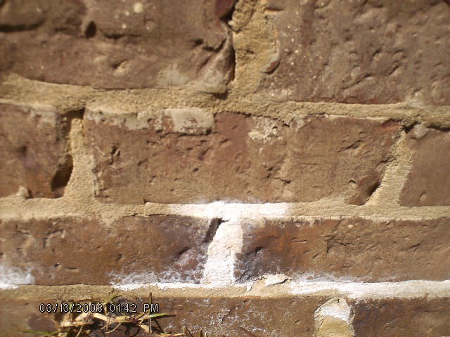

Phillip Posted March 14, 2008 Report Posted March 14, 2008 This is from the house I am inspecting tomorrow. Since it is close to the house I stopped to take a glance at it. Built in 2006 no owner beside the builder. No weep holes and flashing. Water getting in the bricks and coming out at the bottom is my thoughts on this. I haven't seen the inside yet. What do you say? Image Insert: 161.25 KB Image Insert: 118.9 KB
Jim Katen Posted March 14, 2008 Report Posted March 14, 2008 Looks more like rising damp. - Jim Katen, Oregon
Eric B Posted March 14, 2008 Report Posted March 14, 2008 Phillip, As you said, no visible weep holes or flashing. Plus efflorescence in base courses and grading in contact with brick. Have qualified mason blah blah blah. Factual, short and sweet.

Phillip Posted March 14, 2008 Author Report Posted March 14, 2008 It is a Slab foundation. more later today
Brandon Chew Posted March 14, 2008 Report Posted March 14, 2008 I'll take "rising damp with minerals leaching from the slab" for $500, Alex.
Scottpat Posted March 14, 2008 Report Posted March 14, 2008 I'm betting that you will find a bathroom at that window. It could be a plumbing supply or drain leak from the bathtub/shower. I have seen this before and it looks very similar to what you have in the picture.
Phillip Posted March 14, 2008 Author Report Posted March 14, 2008 Here is a photo of it from today. Image Insert: 122 KB It rained last night. I would not of seen it if i did not stop by yesterday. The top of the slab is about 3 ft above the line. There is a bathroom next to the bedroom with the windows. It is a new house no one running the plumbing.

Phillip Posted March 14, 2008 Author Report Posted March 14, 2008 I marked the little red triangle on the water meter and after an hour it had not moved.
Phillip Posted March 14, 2008 Author Report Posted March 14, 2008 Originally posted by Scottpat I'm betting that you will find a bathroom at that window. It could be a plumbing supply or drain leak from the bathtub/shower. I have seen this before and it looks very similar to what you have in the picture. Scott, How did you find out it was a leak in the plumping?
Scottpat Posted March 14, 2008 Report Posted March 14, 2008 Originally posted by Phillip Originally posted by Scottpat I'm betting that you will find a bathroom at that window. It could be a plumbing supply or drain leak from the bathtub/shower. I have seen this before and it looks very similar to what you have in the picture. Scott, How did you find out it was a leak in the plumping? After I ran the tub for a few minutes the mortar started to darken along the area below the bathroom. In my case it was cause by a nail that had punctured the supply line and it only sprayed when the tub was turned on. From what I could tell, the supply line would move just enough when the water was turned on to allow for some water to spray out. When it was turned off the pipe would flex back and onto the nail closing the puncture spot. The builder opened the wall and that is how I found out that a nail had done the damage.
