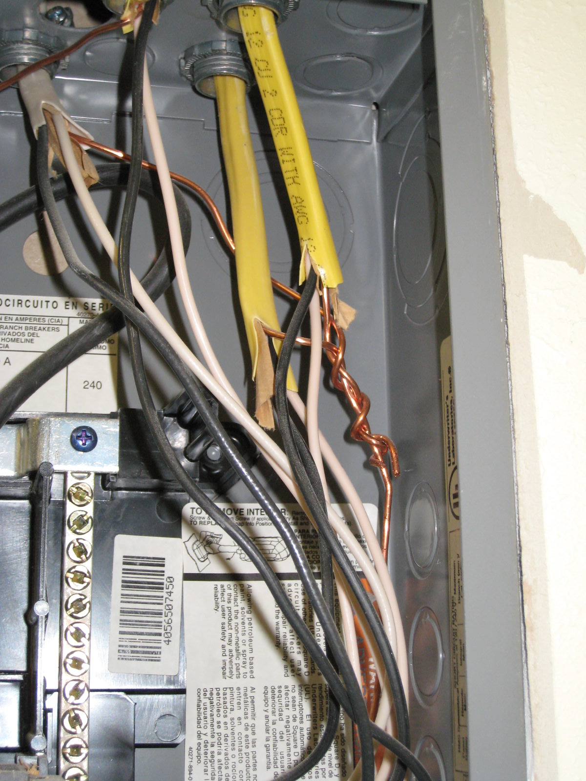

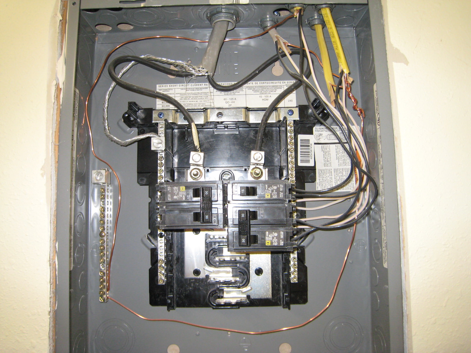

exploreparadise2 Posted March 10, 2008 Report Share Posted March 10, 2008 Here's a chance for some of you to show off your electrical expertise. The photos are from a sub-panel installed in the same building as the main panel. I haven't seen anyone connect the grounding wires this way before. Two wires are wrapped around a third, which is in turn connected to the grounding bar. I see some other issues and input is appreciated. This is going to a long report-writing session, so I'll be able to include comments for a few hours yet. Thanks, Image Insert: 605.4 KB Image Insert: 620.06 KB Link to comment Share on other sites More sharing options...
Ken Meyer Posted March 11, 2008 Report Share Posted March 11, 2008 Sloppy, and obviously not done by a professional or even someone who knew what he was doing. There are only 3 conductors entering the sub panel, there is no neutral. The grounding conductor on the cable coming in looks frayed, and it's connected to the neutral bus bar instead of the grounding bus bar. All grounds should be terminated at the grounding bus bar. Way too much of the romex insulation jacket inside the enclosure. Link to comment Share on other sites More sharing options...
