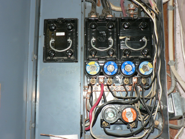

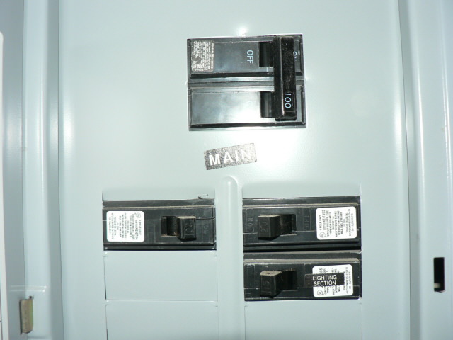

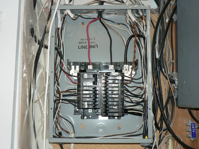

jodil Posted March 8, 2008 Report Share Posted March 8, 2008 A home yesterday built in 57 has 3 panels. Two in basement, 1 in garage. How do you tell where the main breaker is? Panel 1 Image Insert: 218.88 KB Panel 2 Image Insert: 229.47 KB and Panel 3 Image Insert: 133.16 KB Panel 3 cover would not come off (even with all my clients manly power.) It was in the garage. Panel 2~ Does the "double tap" rule apply at fuses? Theres a couple of terminals with two and three hot wires attached? Thank you, Jodi Link to comment Share on other sites More sharing options...
Les Posted March 8, 2008 Report Share Posted March 8, 2008 Jodi, they are all a mess. In fact you, as an inspector, have to go with the label. Then you can report it does not operate as a main and defective. You could make some guesses between #2 and #3. Link to comment Share on other sites More sharing options...

hausdok Posted March 8, 2008 Report Share Posted March 8, 2008 Jodi, I don't think you can necessarily use #3 as the main because it's labeled "main" unless you know that the pull fuse block in the fuse block that's labeled main is not. Obviously, the fuse box is the original but they may have modified the system and relegated it to sub-panel status (In which case it's wrong because of the EGC connected to the neutral bus, among other things. Where was the weatherhead and strike and where do the service entrance cables enter the home? What's behind the narrow metal shield covering that gutter at that large pull-fuse block on the left side of that fuse box? See the middle pull-block that's labeled "main" in the fuse box? The feeders to that block come from that gutter. I'd expect that large pull fuse block in the gutter to be the main disconnect and the SEC's to enter that gutter behind that shield; unless they've reconfigured the service entrance point, that is. Have you ordered Douglas Hansen's book yet? If not, times-a-wastin' that book will save you a whole lot of needless mental strain over the coming years. ONE TEAM - ONE FIGHT!!! Mike Link to comment Share on other sites More sharing options...

Jim Katen Posted March 8, 2008 Report Share Posted March 8, 2008 Originally posted by jodil A home yesterday built in 57 has 3 panels. Two in basement, 1 in garage. How do you tell where the main breaker is? . . . Panel 3 cover would not come off (even with all my clients manly power.) It was in the garage. . . . Panel 2~ Does the "double tap" rule apply at fuses? Theres a couple of terminals with two and three hot wires attached? . . . From the pictures, I can't really tell where the service disconnect is. I might not even be able to tell if I were there unless I could get all of the panel covers off. It sometimes helps to look at the schematic on the fuse boxes. You may find that the service disconnect consists of all three fuse blocks in the fuse panel. I approach these systems by removing the covers from every panel first, then tracing what goes where. From there, I can usually figure out what feeds what. If I can't remove a panel cover, I punt it to an electrician. As for double taps, you aren't supposed to connect more than one wire to one terminal unless that terminal is identified to hold more than one wire. It doesn't matter if the terminal is connected to a bus, a breaker, or a fuse. Even single terminals have this limitation. - Jim Katen, Oregon Link to comment Share on other sites More sharing options...
Richard Moore Posted March 8, 2008 Report Share Posted March 8, 2008 Just looking at Panel 1; it must be a sub-panel fed from the fuse-panel...right? That doesn't have separated grounds and neutrals as required for a sub-panel. In fact, you gotta love the main neutral lug where they have both the ground and neutral from the "main" panel and another large honking conductor (who knows what for) all under the same lug. I think Randy has the right idea... "There are numerous areas of incorrect wiring within and around the two panels that I could access, and also a third panel I could not remove the cover from. (etc, etc, etc...add as much detail here as you want) You should have a qualified, licensed electrician fully evaluate the electrical service and circuit wiring and provide you with estimates for the needed repairs." Link to comment Share on other sites More sharing options...
