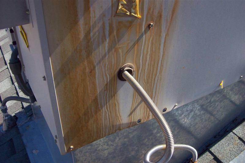

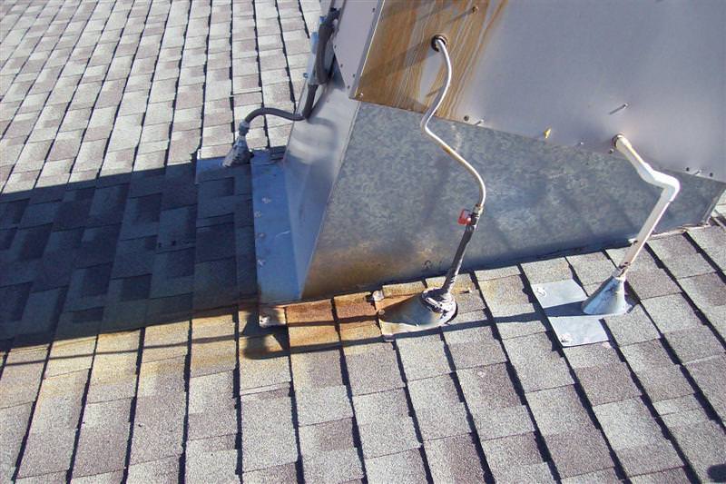

tbird Posted March 7, 2008 Report Posted March 7, 2008 I ran into this today. It is a roof mount gas pack (bundled gas heater and A/C in one unit). There was considerable condensation coming from the exhaust area. The condensation was either rusty or the unit is rusting, I am not positive which was which. Is this an indicator of anything? I have seen slight rust before, but not this much. 80% effecient, low humidity on average (10-20%). Thanks for your help. Image Insert: 97.9 KB Image Insert: 57.96 KB
hausdok Posted March 7, 2008 Report Posted March 7, 2008 Hi Carl, Is there any way for that exhaust to be leaking just inside the housing so that acid is able to condense inside the housing and drain down the sides causing that rust? OT - OF!!! M.
tbird Posted March 7, 2008 Author Report Posted March 7, 2008 Originally posted by hausdok Hi Carl, Is there any way for that exhaust to be leaking just inside the housing so that acid is able to condense inside the housing and drain down the sides causing that rust? OT - OF!!! M. Hey Mike, I don't think that is the case. All the rust appears to be on the outside of the housing only. Would a damaged heat exhanger cause this? It could just be a rusting exhaust cover streaking down the unit?
Bain Posted March 7, 2008 Report Posted March 7, 2008 Or the condensate drain could be clogged and rusty water is seeping out of the evaporator coil seams. Is the coil above what we're seeing?
tbird Posted March 7, 2008 Author Report Posted March 7, 2008 Originally posted by Bain Or the condensate drain could be clogged and rusty water is seeping out of the evaporator coil seams. Is the coil above what we're seeing? The coils and pan sit low (see the condensate line on the first picture, right side). Sorry, I thougth I took a picture of the actual exhaust outlet but I cannot find it. It is only a metal shield over the exhaust opening. Kind of like this =]
Scottpat Posted March 7, 2008 Report Posted March 7, 2008 If it is an older unit with a cast iron heat exchanger it could very well do that. It looks like it is sitting on a 20 degree slope, I'm sure that is just the angle you took the picture.
tbird Posted March 8, 2008 Author Report Posted March 8, 2008 Originally posted by Scottpat If it is an older unit with a cast iron heat exchanger it could very well do that. It looks like it is sitting on a 20 degree slope, I'm sure that is just the angle you took the picture. I was tilted when taking the pictures. The date on the unit is a 1998. Thanks
Scottpat Posted March 8, 2008 Report Posted March 8, 2008 Originally posted by tbird Originally posted by Scottpat If it is an older unit with a cast iron heat exchanger it could very well do that. It looks like it is sitting on a 20 degree slope, I'm sure that is just the angle you took the picture. I was tilted when taking the pictures. The date on the unit is a 1998. Thanks It could be a cast iron heat exchanger if it is a 1998 model. That is what I would put my money on. Have an HVAC contractor remove the cabinet and inspect the heat exchanger.
