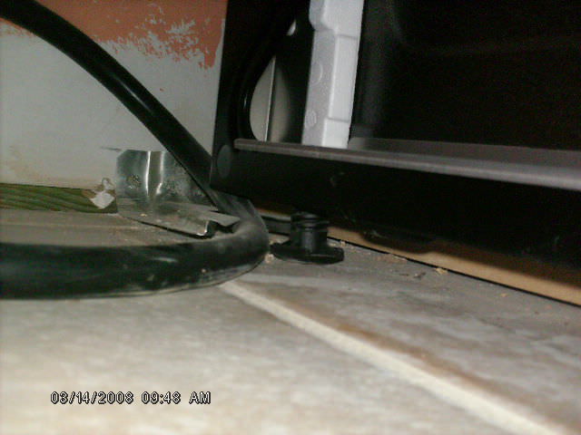

Phillip Posted March 14, 2008 Report Posted March 14, 2008 The anti-tip bracket was installed on the stove of todays inspection. Some one did not pay attention when sliding the stove in place Image Insert: 73.47 KB
ozofprev Posted March 15, 2008 Report Posted March 15, 2008 Cool, they also make great cable-cutters!
