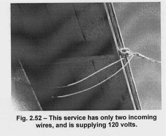

hausdok Posted March 5, 2008 Report Share Posted March 5, 2008 Here's a scanned picture from Electrical Inspection of Existing Dwellings - 2001 Edition by Douglas Hansen of a 120-volt service. I sure hope my friend Douglas doesn't chew me a new one over this, but I doubt if I'll ever get a chance to take a picture of one. OT - OF!!! M. Link to comment Share on other sites More sharing options...
Les Posted March 5, 2008 Report Share Posted March 5, 2008 I can't count how many two wire drops we have seen. Thousands. There was a 4-5 sq block section of Lansing Mich that was 120vac until 10-15yrs ago. So it is possible, but not likely. There are still houses here that have 30amp entrances. And houses that had split entrances: one for you and one for neighbor. Jodi's question is one that I've seen avoided by new inspectors for decades - she had the gumption to ask it! Link to comment Share on other sites More sharing options...
Richard Moore Posted March 5, 2008 Report Share Posted March 5, 2008 That looks exactly like the old, original KT feed from my house to my garage. Link to comment Share on other sites More sharing options...
jodil Posted March 5, 2008 Author Report Share Posted March 5, 2008 Yes that picture is exactly what Im talking about. Well, neither electrician I know can stop by during this inspection, so I am going to have to wing it...any advice? I tried to find the Code check electrical fill in chart Randy suggested but could not find it. Any one know where I can go to get that? No I am not prepared to figure it out, and I will let the buyer know that. But I would like to give it my best shot for my own experience. Thanks Jodi Link to comment Share on other sites More sharing options...

kurt Posted March 6, 2008 Report Share Posted March 6, 2008 I don't think it's too much of a stretch to say the service can't handle central AC. Jodi says Mike's pic is exactly what it looks like. That's 120v, no? If it's a 2 wire feed, it's a near sure bet that the panels are inadequate, and the distribution wiring is a rats nest of various issues. I rarely see them anymore, but the 120v systems I've looked at always needed mega-upgrades throughout. I agree w/doing the load calc. It isn't complicated. Jodi should do a couple simply to get comfortable w/the idea. You run a simple formula, you come up w/a number. If the house has a 120v feed, you know the panels should be updated. Not updating would be a ridiculous false economy. Jodi, get pics and post after the gig; the answer will probably be very apparent. Link to comment Share on other sites More sharing options...

Jesse Posted March 6, 2008 Report Share Posted March 6, 2008 If it's really just a 2-wire service, no load calc necessary. It's an inadequate service, regardless of AC. New service drop, new service panel, probably new sub-panels. With all that, and other details that are sure to come up, they should be set to run central air. Link to comment Share on other sites More sharing options...
