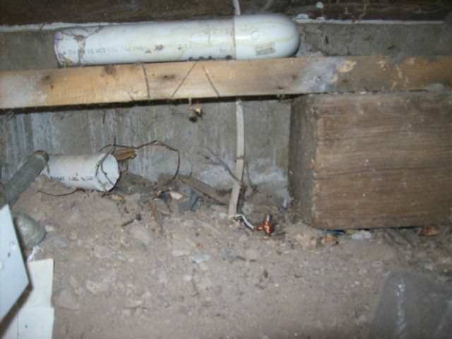

mridgeelk Posted February 27, 2008 Report Posted February 27, 2008 Yesterday I found this in a crawlspace, a jury-rigged ground. Same situation as yours, tripped to itself but not to the tester. The tester showed that was grounded. Image Insert: 300.53 KB Originally posted by jodil This may be a dumb question, but Id rather get the dumb ones out while Im still new, versus having a client correct me. Why would a GFCI protected outlet trip when the test button is pushed on the actual outlet, but not trip when I push the test button on my tester? Just so you know the tester registered the outlet as being correctly wired. Thanks for your response.
