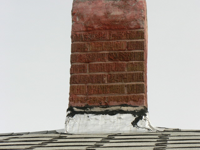

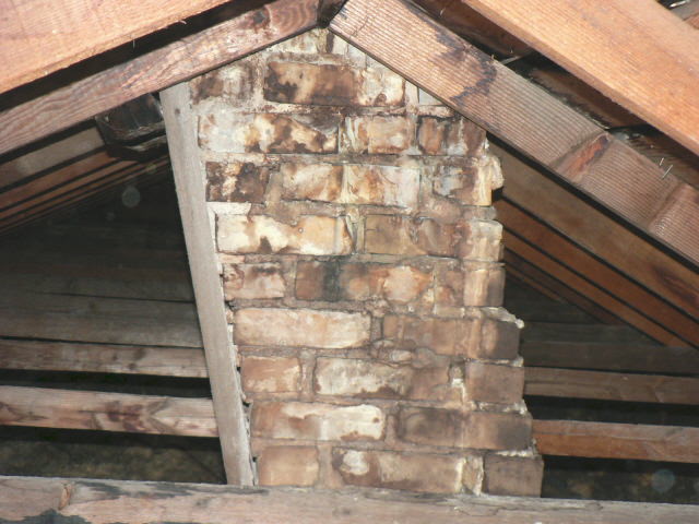

jodil Posted February 26, 2008 Report Share Posted February 26, 2008 This house I inspected today was "remodeled" and I'm pretty sure the handyman/flipper must have been high... Is this flashing material anyone has ever seen? Im new so I am only familar with the sheet metal type. Keep in mind that there was an active leak viewed in the attic around the chimney (roof decking was soaked and rotted.) Also the chimney in the attic mortar was like sand and falling out in chunks. How would you report this and what would you suggest be done to fix? Image Insert: 135.98 KB Download Attachment: zchim2.jpg 220.31 KB Link to comment Share on other sites More sharing options...
hausdok Posted February 26, 2008 Report Share Posted February 26, 2008 That's a form of peel-n-seal. It's wholly inadequate for what it's being used for and gooping it up with asphalt cement will only cause the bituthene backing to break down. It's more likely that the water is getting in through the crown and the flue or through worn mortar where the counter flashings had been let into the stack, or though a cracked/missing crown, and is then migrating to the roof framing and decking. What's the top of that stack look like? Do you still see those T-tab lockdown shingles a lot in North Dakota? They haven't been used regularly around here for over a quarter of a century. ONE TEAM - ONE FIGHT!!! Mike Link to comment Share on other sites More sharing options...

Bill Kibbel Posted February 27, 2008 Report Share Posted February 27, 2008 It's official product name is self-adhesive, foil-backed flashing tape - trailer-park home compatible. Link to comment Share on other sites More sharing options...

kurt Posted February 27, 2008 Report Share Posted February 27, 2008 Originally posted by jodil Also the chimney in the attic mortar was like sand and falling out in chunks. How would you report this and what would you suggest be done to fix? Not sure how one gets a chimney into attic mortar. What is attic mortar, anyway? Most likely the mortar in the chimney is completely shot due to excessive moisture caused by the lack of a liner. Moisture in the combustion gas condenses and eventually demolishes the mortar and brick. If it's just falling apart, you may need a complete rebuild. It sounds like you definitely need a liner. Both things are expensive. I'd report it as a major defect needing repair; have a contractor tell the buyer what it would cost. I could be wrong, but I see a lot of old chimneys...... Link to comment Share on other sites More sharing options...
jodil Posted February 27, 2008 Author Report Share Posted February 27, 2008 Pardon my ignorant choice of words Kurt G. I didnt know our posts were being scrutinized by an English major... I'm pretty sure you know what I meant. The mortar between the bricks in the chimney located in the attic. better? Originally posted by kurt Originally posted by jodil Also the chimney in the attic mortar was like sand and falling out in chunks. How would you report this and what would you suggest be done to fix? Not sure how one gets a chimney into attic mortar. What is attic mortar, anyway? Most likely the mortar in the chimney is completely shot due to excessive moisture caused by the lack of a liner. Moisture in the combustion gas condenses and eventually demolishes the mortar and brick. If it's just falling apart, you may need a complete rebuild. It sounds like you definitely need a liner. Both things are expensive. I'd report it as a major defect needing repair; have a contractor tell the buyer what it would cost. I could be wrong, but I see a lot of old chimneys...... Link to comment Share on other sites More sharing options...
kurt Posted February 27, 2008 Report Share Posted February 27, 2008 Nope, not an English major. Of course I knew what you meant, but if you're new to the biz, and you want to survive, here's some good advice. Don't operate on the assumption that someone knows what you mean. Learn to express yourself in ways that cannot be misunderstood. Folks saying and doing goofy things, and then being amazed and mildly put out when folks call them on it, is the hallmark of the doofus HI. Get over this as quickly as you can, or some attorney will school you in ways that are much more aggravating than anything that could happen in here. Link to comment Share on other sites More sharing options...

Les Posted February 27, 2008 Report Share Posted February 27, 2008 Jodi, you "guys" might really benefit from having a report read by another inspector. Five or six of the posters on this board have sent me a representative report to read and were quite surprised by the critique. Couple of them still speak to me! Kurt's advice is really on point. Mike O gave you some clues and info regarding the mat'ls as did Bill K and Brian G. The brick chimney mortar will be "different" than the exposed mortar above ridge and likely the brick is different. (it is) Maybe same type brick, but bricks that are not chipped, broken cracked etc that were used in the attic space. Link to comment Share on other sites More sharing options...
