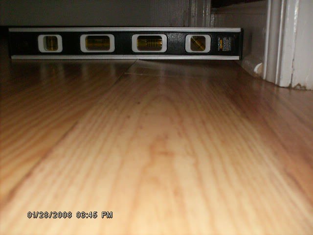

Phillip Posted February 12, 2008 Report Posted February 12, 2008 Look at these photos and tell me what you see wrong. The pipe is from the second floor bathroom. Image Insert: 80.28 KB Image Insert: 79.74 KB Image Insert: 71.01 KB
Phillip Posted February 12, 2008 Author Report Posted February 12, 2008 The report these are from was done 3 weeks ago. These are some of the photos that will be going to court. I was wanting to have y'all to look and them and make comments on what you see.
Chad Fabry Posted February 12, 2008 Report Posted February 12, 2008 Not sure what you're after, but there should be hangers or a ledger for the joist. If the second photo is a beam it doesn't look like it has adequate bearing?
Jim Katen Posted February 12, 2008 Report Posted February 12, 2008 I see no purple primer on the PVC joints. I see no joist hanger under the joist. I'm probably missing the larger point that you're trying to make though. - Jim Katen, Oregon
Phillip Posted February 13, 2008 Author Report Posted February 13, 2008 The beam is 2 - 2 x 10 with a 2 x 8 nailed on it for the ledge board. The pipe is run in the load barring wall. The house has two stories and a conventional framed attic.
kurt Posted February 13, 2008 Report Posted February 13, 2008 I'm still not sure what you're after; the pictures aren't telling me anything in particular beyond what Chad and Jim have said. Not sure what a ledge board is; is that local nomenclature for a sill? If it is, the board should be treated. What does the plumbing pipe drain? A shower or a sink? If it's a shower, it should be 2". It this is going to court based on the pictures, the court might not understand what we're looking @ without a broader field of view to see what all this stuff is. Also, it's a bearing wall, not a barring wall.
Chad Fabry Posted February 13, 2008 Report Posted February 13, 2008 Does the bearing wall run perpendicular to joists or parallel? If it's parallel you're saying that the bearing wall isn't over a doubled joist and in fact, isn't over a joist at all as is evidenced by the plumbing that is concealed in said wall? Or if it's perpendicular are you saying that it's not over the beam? Exactly what the heck are you writing about? Image Insert: 130.41 KB
Steven Hockstein Posted February 13, 2008 Report Posted February 13, 2008 I am assuming that there are many more issues involved in this case. The cost of litigating will be substantially more than correcting the problems you have shown.
hausdok Posted February 13, 2008 Report Posted February 13, 2008 Hi, Phillip, I too am struggling to understand exactly what it is that you are asking. Simply showing us a picture of a joint between a couple of framing members, without any background or better photographs, doesn't give us anything to go on. I can't be sure, but it looks like you/re fishing for someone to come to the same conclusion you did, whatever that was. However, without establishing photos and a better idea of what we're looking at, that's impossible. Why don't you just tell us what's going on and give us further background about what we're seeing in this pictures, so that we can voice a more informed opinion? OT - OF!!! M.

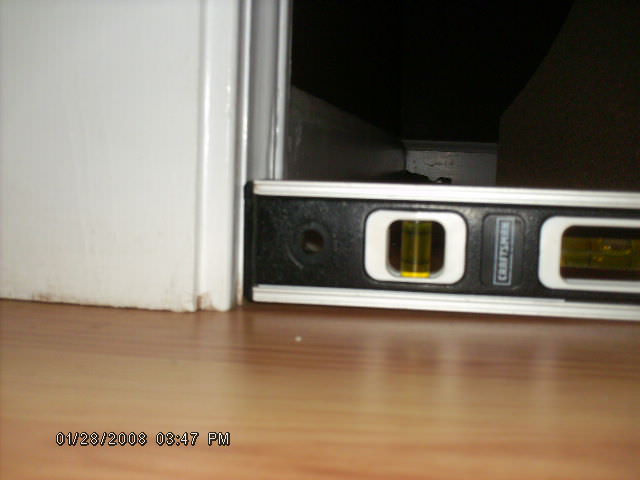

Phillip Posted February 13, 2008 Author Report Posted February 13, 2008 I was trying to see what some one would say with the limit view of the photos. The set up is close to what Chad has posted. There are other bearing wall that are not setting on doubled up joist. Kurt, I guess I should of said ledger strip not ledge board, which is suppose to be nailed on the side of the beam to support the joist when you do not use joist hangers. The drain comes from the tub on the second floor. Here is a photo of the wall that the pipe is in on the inside of the house. Image Insert: 64.11 KB Here is one of the other bearing walls Image Insert: 54.91 KB Here is where the stairs have moved from when I inspected it 3 years ago. Image Insert: 62.52 KB Right now a price has been given of $40,000 for the known repairs needed.

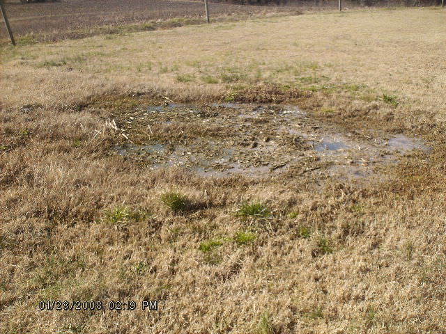

Phillip Posted February 14, 2008 Author Report Posted February 14, 2008 The builder did neglect to erect the main-level load-bearing wall on top of the pier and beam system in the crawlspace. The ceiling joists in the attic is on top of the mis-located main-level load bearing wall. There are other things wrong with the house. The main electrical panel is in the master bedroom closet along with other problems. The whole house is plumbed with 1/2' cpvc. There was an one inch line from the meter to the house. S-traps where used and the kitchen sink and washer drain pipe backs up. Lack of vents along with leaks. The crawlspace is only vented on two sides. Improper flashing of the roof. Missing railing at the porch and steps. The interior walls and ceiling of the garage is covered with vinyl siding. The heat pump in the attic does not have the clearance to be worked on, no floored area to it and no light. No egress windows in the bedrooms upstairs. The house was built in 2004 and no AHJ. This is just part of the problems. The septic tank look just like this in 2005. Image Insert: 168.77 KB
