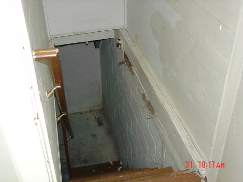

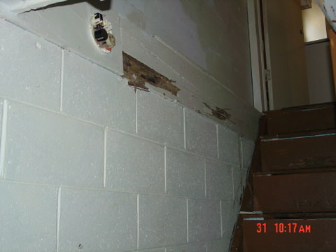

Les Posted February 12, 2008 Report Posted February 12, 2008 I didn't probe any of these areas. I sensed them just by looking closely! Image Insert: 74.39 KB Image Insert: 62.72 KB Image Insert: 77.75 KB Image Insert: 85.93 KB Image Insert: 85.8 KB
