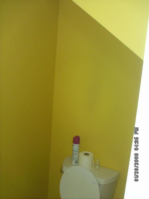

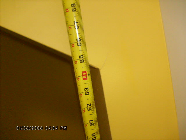

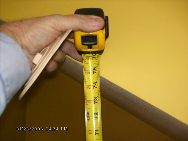

Phillip Posted January 29, 2008 Report Posted January 29, 2008 Hi to all, I have an bathroom in a home built in 2004. It is up stairs The ceiling hight is 7 ft. The ceiling over the toilet slopes. Where in the 2003 IRC can I find this? Here are the photos. The toilet. Image Insert: 38.71 KB Here is the height at the center of the toilet. Image Insert: 62.58 KB Here is the low point. Image Insert: 53.22 KB Thanks
kurt Posted January 29, 2008 Report Posted January 29, 2008 R305.1 Exception 3 - for rooms w/sloped ceilings, minimum 50% must have a ceiling height of 7' and no portion of the required floor area may have a ceiling height of <5' Exception 4 - Bathrooms minimum ceiling height of 6'8" over the fixture, and at the front clearance (21" in front of toilet) for fixtures shown in Figure 307.1 I don't think they have the required headroom over the toilet.
