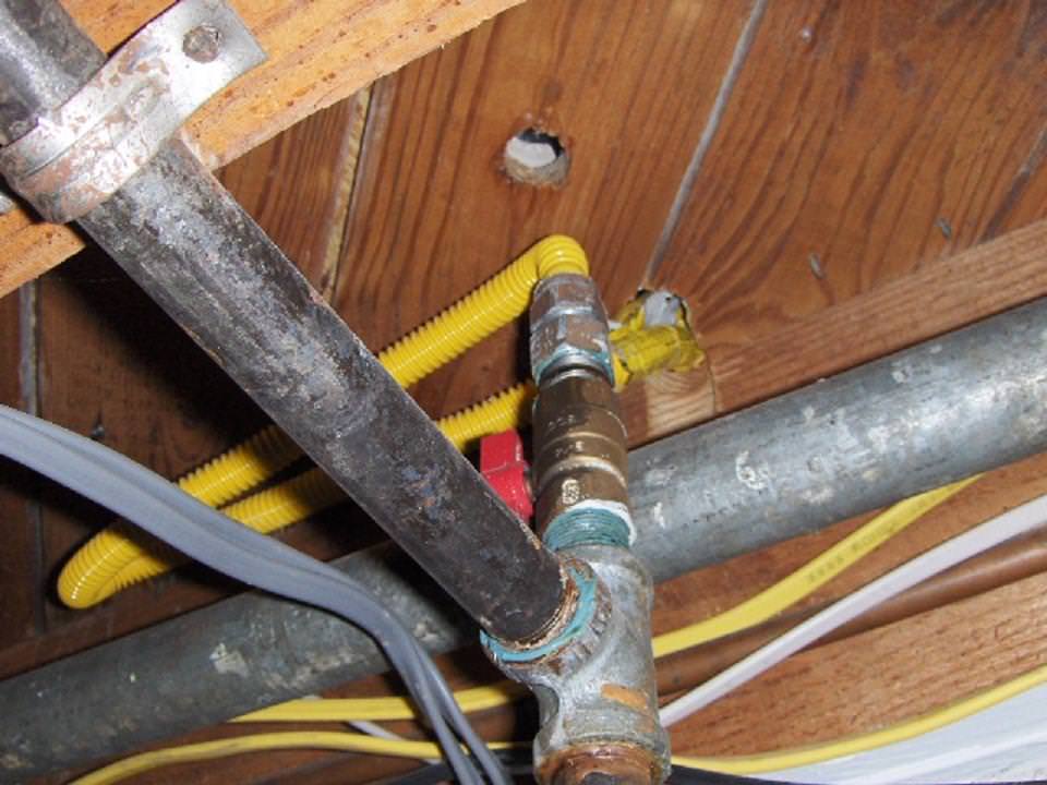

CSST has the yellow jacket. Some connectors also have a yellow jacket, but I've never seen one in sizes as large as the diameter shown there.
It's obviously a supply pipe coming through the rim and it supplies gas to that down-pipe. Somewhere out of sight of that picture, that downpipe connects to the water heater and the boilder/furnace and there may or may not be a flexible connector at the end of that downpipe between the piple and the appliance.

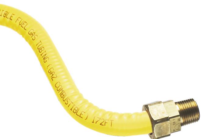

Here is a picture of a flexible connector with a yellow jacket. I called this one out on a job I did. Can I assume that the CSST has more smooth surface? At least thats how it appears in pictures I just searched for.

Yeah, I've seen connectors like that. See the way the corrugated section stops short of the fitting? CSST goes right up into the fitting.

For future new HIs, here's a pic of csst:
And here's a connector with a yellow jacket:

Thanks for the pics Bill. Now wouldn't you admit how it could be easy for the less experienced to get the two mixed up?

It was CSST and feeds a gas stove in the kitchen above this area. Does this type of installation for CSST require a sleeve (like a short peice of PVC pipe) where the CSST passes through the floor?
I call this out all of the time for CSST feeding gas fireplaces. You check out the CSST right where it passes through the metal opening and often it is burred. Sometimes I find leaks here too.
Posted
Simple answer, no.

So, was AHI confusing the CSST with appliance connector material? (see top of this page)
CSST doesn't need a piece of PVC pipe (for example) where it passes through a floor or wall, but a plastic appliance connector does? I see the plumbing code requires flexible tubing to be protected from mechanical damage, such as where it passes through something.
