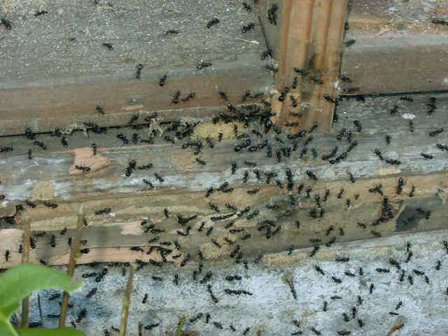

Brandon Whitmore Posted May 18, 2008 Report Share Posted May 18, 2008 I have a carpenter ant problem at my house right now. I just purchased the home this last winter, so I am unsure how well they are established. I found activity when I purchased the home, but decided to wait until they became active to treat, etc. I believe I have located a main nest outside at one corner of my house, and 2 satellite colonies in the home. The activity is limited to the S. side of my home. There is no plumbing in these areas, just bedroom's. I can find absolutely no moisture, rot, or damage anwhere in the home. I believe they are getting the moisture from the exterior. I am trying to decide whether I want to have a pest control professional treat the home, or if I want to just set out bait in these areas and see if I can kill the buggers off that way. I prefer not to spray as I don't want a bunch of chemicals in or around my home. I may try to mix some boric acid with some sugar and peanut butter and set bait in the areas of activity. Anyone have any better ideas for treatment,or advice? Link to comment Share on other sites More sharing options...

Brandon Whitmore Posted May 18, 2008 Report Share Posted May 18, 2008 Is that the house on College? I thought I saw your rig there the other day. That's the one-- did the ants wave on the way by? I believe that it was based on a mixture of corn syrup and boric acid. You could probably make it yourself. The trick is to inclulde enough boric acid to eventually kill the ants, but not so much that they won't take it. I'll try both tonight and see which one they prefer. If I let the little guys live so I can watch them, I'll end up sleeping alone. Thanks Link to comment Share on other sites More sharing options...
John Dirks Jr Posted May 18, 2008 Report Share Posted May 18, 2008 This product worked for me. It took a few weeks but eventually they disappeared. It's been a couple of years and they havn't returned. The stakes are what I used. http://www.grantsproducts.com/ant_contr ... trolstakes Link to comment Share on other sites More sharing options...
Brandon Whitmore Posted May 20, 2008 Report Share Posted May 20, 2008 I have a pest control guy that swears by Termidor. All that is required is a perimeter treatment. There is no need to drill into the siding or perform other intrusive work, and best of all there will be no chemicals inside the home. Any of you guy's have any experience with the stuff? Link to comment Share on other sites More sharing options...
