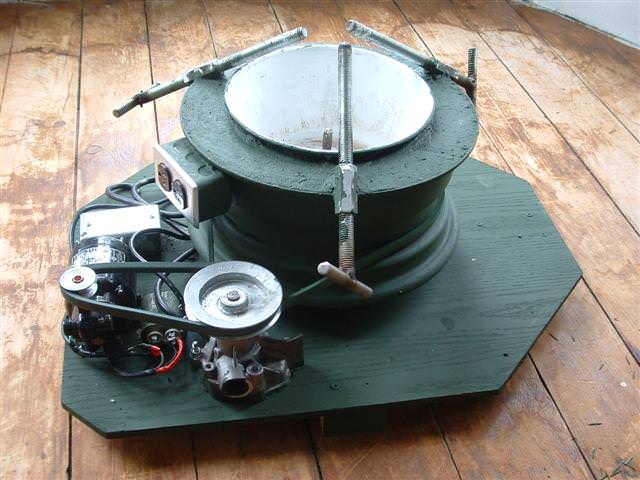

Chad Fabry Posted December 15, 2007 Report Share Posted December 15, 2007 My Dad built one for himself, then 1 for each of the family members. They're all made out of junk and each is different. You don't want your infant kids playing unattended, but they work well and the effect is cool. Why don't the cords wind up? The standard answer is 'we use long cords and change the direction once an hour.' Most folks are satisfied with that response. Image Insert: 67.87 KB Image Insert: 59.25 KB Link to comment Share on other sites More sharing options...
Brad Manor Posted December 15, 2007 Report Share Posted December 15, 2007 I really like it!!! And, since the water pump is there already, it could have an automatic watering system without too much more work. [] -Brad Link to comment Share on other sites More sharing options...
Jim Katen Posted December 15, 2007 Report Share Posted December 15, 2007 Originally posted by Chad Fabry My Dad built one for himself, then 1 for each of the family members. They're all made out of junk and each is different. You don't want your infant kids playing unattended, but they work well and the effect is cool. Why don't the cords wind up? The standard answer is 'we use long cords and change the direction once an hour.' Most folks are satisfied with that response. The receptacle turns with the tree. I used to build giant turntables (15' - 30' in diameter). We'd use two metal rings under the turntable and strips of metal from a coffee can to work as brushes to carry the juice to them. Did your dad do something similar? - Jim Katen, Oregon Link to comment Share on other sites More sharing options...

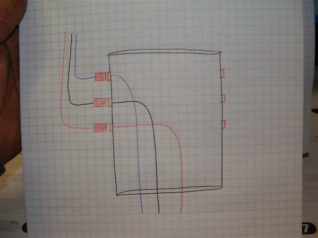

Chad Fabry Posted December 15, 2007 Author Report Share Posted December 15, 2007 The receptacle turns with the tree. I used to build giant turntables (15' - 30' in diameter). We'd use two metal rings under the turntable and strips of metal from a coffee can to work as brushes to carry the juice to them. Did your dad do something similar? He cut 3" copper tubing into 1/2" slices, like rings and pressed them over schedule 40 PVC. Delco alternator brushes carrying the current to the receptacle. Link to comment Share on other sites More sharing options...
Jim Katen Posted December 16, 2007 Report Share Posted December 16, 2007 Originally posted by Chad Fabry . . . He cut 3" copper tubing into 1/2" slices, like rings and pressed them over schedule 40 PVC. Delco alternator brushes carrying the current to the receptacle. That's a tidy solution. But surely he must have used two different sizes of tubing to make concentric rings? - Jim Katen, Oregon Link to comment Share on other sites More sharing options...

Chad Fabry Posted December 16, 2007 Author Report Share Posted December 16, 2007 That's a tidy solution. But surely he must have used two different sizes of tubing to make concentric rings? Image Insert: 40.65 KB Link to comment Share on other sites More sharing options...
