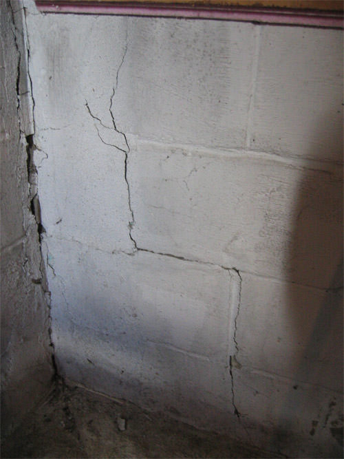

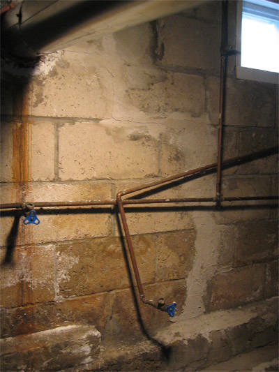

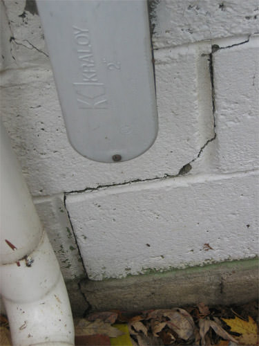

ambrosia Posted October 29, 2007 Report Share Posted October 29, 2007 Hello. I am considering to buy a house in a waterfront and found many cracks in the basement cinder block wall. Some are vertical and some others are stair step crackings. The house is built in 1948 and once there was water infiltration through the basement walls, but never afterwards, that is what the real estate agent of the seller side says. I attached a couple photos of the cracks below. First 3 photos are from inside the basement and last 2 photos are from outside the house. You can see some cracks patched up. Image Insert: 50.9 KB Image Insert: 64.92 KB Image Insert: 79.12 KB Image Insert: 51.51 KB Image Insert: 45.48 KB What do you guys think is the cause of those cracks? Is this a settlement problem? If so, how serious is it? Is this good idea to buy this house? I am concerned if the cracks would give more problems after we buy it. Thanks. Your advice is greatly appreciated. Link to comment Share on other sites More sharing options...

Chad Fabry Posted October 29, 2007 Report Share Posted October 29, 2007 photo 1) proves ongoing water instrusion..paint has been "pushed" off of the wall photo 2) the same thing..stains around penetrations... efflorescence and the repair has opened since applied. photo 3) corner joint broken and stair step crack since last painting photo 4) stair step and some differential separation since last painting Things are moving. Water is entering. Around here lake front homes are built on extremely fine soils that compact well but don't drain. The local glacial till is like crusher run...all sizes of aggregates that after some time become tightly compacted and hold water. Drainage is paramount: large roof overhangs w/ fully functioning gutters can do a lot to keep foundations stable in poorly draining soils. To be accurate: The block in the photos is concrete, not cinder. Link to comment Share on other sites More sharing options...

kurt Posted October 29, 2007 Report Share Posted October 29, 2007 Sounds like there are no long horizontal cracks; those are the ones where the earth is pushing the wall inward. It all looks like settlement caused by excessive moisture. And, forget what the realtor says; they have no idea whatsoever how many times there's been water in the bsmt. I think there's ongoing water entrance. Link to comment Share on other sites More sharing options...

ambrosia Posted October 30, 2007 Author Report Share Posted October 30, 2007 Hi everyone, Thanks for your responses. It gives me a very good starting point. From the outside of the house, it seems like most of the measures youââ¬â¢ve mentioned were already in place. The grading had a slope going away from the house The water from the downspouts was redirected away from the house In picture 4, we can see that there is some black coating on the lower part of the foundation. I assumed this was an external membrane used to waterproof the foundation from the outside. However, I still donââ¬â¢t know if there is a footing drain. Iââ¬â¢ll try to find out if these measures were implemented by the current owner. Especially, since you are saying that it is an ongoing problem. Thanks to you all, and donââ¬â¢t worry, if I put an offer on the house I will have it inspected. Philip Link to comment Share on other sites More sharing options...
