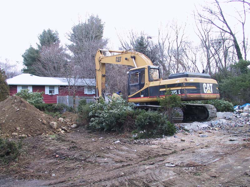

Gerry Beaumont Posted March 28, 2004 Report Share Posted March 28, 2004 Hi to all, Chad, just included an extra picture in your report. this one should get the concept across [:-eyebrows] [:-glasses] [:-eyebrows] Download Attachment: demo_20_s.jpg 127.05 KB Link to comment Share on other sites More sharing options...
a46geo Posted March 28, 2004 Report Share Posted March 28, 2004 Chad, Copy that photo, It will come in handy many times over your HI Ka-Rear. George Link to comment Share on other sites More sharing options...
