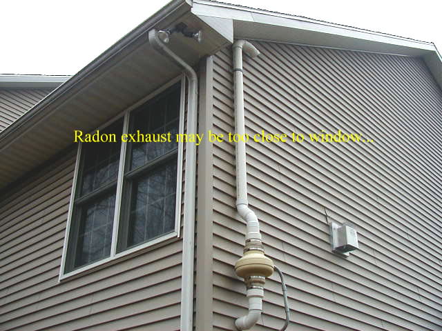

Jeff Remas Posted March 26, 2004 Report Share Posted March 26, 2004 Anyone know what the rules are for this one? I believe it has be be 10 away from any window unless it is 2.5 feet above the window. Thoughts? Download Attachment: P3251177.JPG 95.5 KB Link to comment Share on other sites More sharing options...
Brian G Posted March 26, 2004 Report Share Posted March 26, 2004 It's a minimum of 10 feet from any opening less than 2 feet below discharge. Also a minimum of 10 feet: from any adjacent building from public or private access above grade Brian G. The Only Nationally Certified Radon Guy In Mississippi (NEHA)[^] Link to comment Share on other sites More sharing options...

Bill Kibbel Posted March 26, 2004 Report Share Posted March 26, 2004 Jeff, there are 2 issues. 1. Point of discharge should be above the eave of the roof. 2. Point of discharge should be ten feet or more from any window, door, or other opening that is less than two feet below the exhaust point. The distance from the point of discharge to openings may be measured either directly between the two points or be the sum of measurements made around intervening obstacles. I suggest obtaining a copy of the EPA's publication: Radon Mitigation Standards. Link to comment Share on other sites More sharing options...
