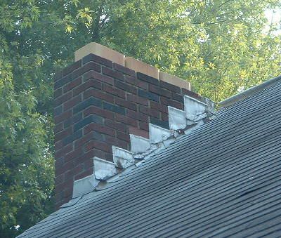

msteger Posted October 10, 2007 Report Share Posted October 10, 2007 Ran across this chimney yesterday. The top of the flues (3) were only 2"~4" above the adjacent ridge vent. I discussed the 10-2-3 rule with the client. A little short, huh? Image Insert: 44.33 KB Link to comment Share on other sites More sharing options...

Chad Fabry Posted October 11, 2007 Report Share Posted October 11, 2007 What do the flues vent? Link to comment Share on other sites More sharing options...
John Dirks Jr Posted October 11, 2007 Report Share Posted October 11, 2007 Also, the flues should not be so close to each other. There should be a row of brick between them. (wythe) I am very curious as to when the 10-2-3 rule came into effect. Anyone know what year? If the chimney was built prior to that rule then perhaps it could be approached as a suggested upgrade rather than a defect. My point being that newer codes are not usually enforced upon retroactively. I see many chimneys in my area on older homes that do not meet the 10-2-3 rule. I am trying to find an option to calling them all defective. Link to comment Share on other sites More sharing options...

hausdok Posted October 11, 2007 Report Share Posted October 11, 2007 Dollars to donuts that stack used to be much higher. Here's what happened: The crown cracked, water permeated the stack and ruined the mortar in the top few feet and made the parapet unstabile. Some enterprising individual said, "Hey, I don't have to rebuild that thing, I can just take it down to good mortar and stick a new crown on it." Write it up as wrong. Don't try to justify it or to figure out whether it should be "grandfathered" - just write it up. ONE TEAM - ONE FIGHT!!! Mike Link to comment Share on other sites More sharing options...
chicago Posted October 11, 2007 Report Share Posted October 11, 2007 I was wondering what's going on with the step flashing. It looks peeled up at the bottom. Link to comment Share on other sites More sharing options...
SonOfSwamp Posted October 11, 2007 Report Share Posted October 11, 2007 Originally posted by chicago I was wondering what's going on with the step flashing. It looks peeled up at the bottom. That happens when jackleg roofers put on a new layer of shingles, but just bend the original flashing out of the way, instead of replacing it (which would have been the right thing to do). WJ Link to comment Share on other sites More sharing options...

msteger Posted October 11, 2007 Author Report Share Posted October 11, 2007 To answer a few of the above questions - The home had 2 wood burning fireplaces (living room and basement) and an oil fired boiler (for a total of 3 flues). The middle flue was also cracked vertically on the side facing the camera (look closely at the photo). I explained the lack of proper chimney height to the buyer and recommended full evaluation and level 2 clean/service by a qualified chimney professional. I also noted the flashing that needed to be repaired. The chimney is original. The sellers were original owners and claim to not have changed anything regarding the chimney. The home was built around 1948. As noted in the original post, there is indeed a ridge vent adjacent to the chimney, and only maybe 2' from the top of the closest flue. As I explained to the buyer, the 10-3-2 rule essentually says that the chimney must pass through the roof at least 3' (on the high roof side) and must be at least 2' higher than anything 10' away from the flues. Did I explain this correctly? I explained to the client that the 10-3-2 rule may not have existed in 1948 (and may not have until recently in many areas since I am in PA), yet should be addressed for safety reasons. Some of these safety reasons pertained to fireplace/boiler exhaust being able to re-enter the home through the adjacent ridge vent, as well as potential drafting issues. Link to comment Share on other sites More sharing options...

hausdok Posted October 12, 2007 Report Share Posted October 12, 2007 Sure, They can backdraft. Read my post again, I said that, "unless the attic ventilation is completely screwed up and simply isn't functioning at all," but that's part of the inspection too. Right? If the attic isn't venting properly, there should be plenty of evidence of that to report. The chimney height requirement concerns ensuring that there is sufficient height so that the chimney will draw properly and that the chimney won't back draft. Air passing over that ridge will tumble. It's well established - pilots have known for decades not to fly too close to the crest of a cliff face and must take precautions when topping the ridge of a mountain because of it. If the stack isn't high enough, that tumbling air will flow down the flue and cause the fireplace to backdraft. Making the proximity of a ridge vent a concern is a bad call and just creates inspectlore. Call it because the stack is too short but don't call it because you're afraid that the ridge vent will decide on its own to defy the laws of physics and turn into a vacuum cleaner somehow magically pulling the smoke into the house through a vent where convection currents are already flowing out of the house. That's all I'm saying. ONE TEAM - ONE FIGHT!!! Mike Link to comment Share on other sites More sharing options...
