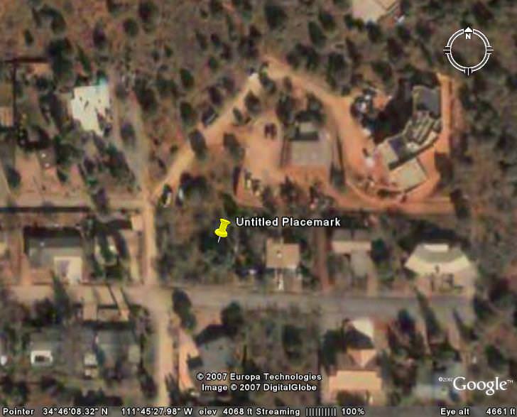

homnspector Posted September 15, 2007 Author Report Posted September 15, 2007 Walter, there's nothing wrong with that, I just never felt it was fair to the client when I was perfectly capable of walking on the roof without hurting anything. Now I may have to re-think that. It seems like with all the technology available, there must be some way to document the journey up the roof that leaves no doubt that the damage was there already. Something like you suggested about showing pictures to the client from the roof edge before venturing up, but it would be nice to be able to do it alone.
Les Posted September 15, 2007 Report Posted September 15, 2007 Walter, Good thought and nice words! That is the sort of comment we try to make. We have to exclude roofs for several months per year because of snow cover. We tell folks everything we can, but are very careful to make clear what we could see and what we can't see.
homnspector Posted September 15, 2007 Author Report Posted September 15, 2007 Here it is on Google Earth. Darn, it's not built yet, I guess that won't work. Image Insert: 60.77 KB[/size=1
