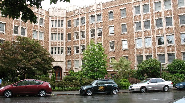

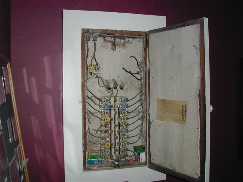

Richard Moore Posted August 21, 2007 Report Share Posted August 21, 2007 Here's a fun one from an apartment in a 1928 co-op building. Open the panel door and you are faced with this.... Image Insert: 106.19 KB 4 fused neutral 15 amp circuits (5 if you count the double tap), 40-amp 240 for the range, and lots of nasty exposed bits to electrocute you. My first fused neutrals! I'm a proud papa! Out of town client buying it for his son while he attends the UW. I gotta believe he will be concerned about the safety issues. Cool old building though...steam heat, common hot water, etc, etc. Image Insert: 112.8 KB Link to comment Share on other sites More sharing options...
kurt Posted August 21, 2007 Report Share Posted August 21, 2007 Nice! Gives one a little perspective on where we've come from. This is one I found; parts were still active, some wires were clipped. Image Insert: 61.28 KB Link to comment Share on other sites More sharing options...
Neal Lewis Posted August 21, 2007 Report Share Posted August 21, 2007 That panel still has what may be/could be possible asbestos type material in there. Link to comment Share on other sites More sharing options...
