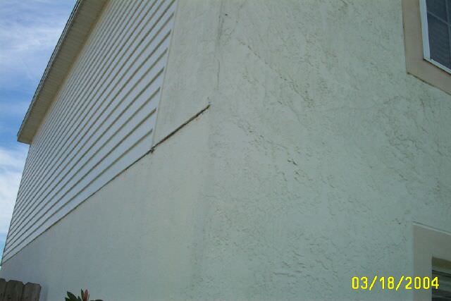

Danny Pritchard Posted March 18, 2004 Report Share Posted March 18, 2004 I'm curious as to how the rest of you would report the lack of an expansion joint at the 2nd floor.This is a 5 year old home with concrete block at the 1st level and wood framing above.At the left side corner the builder has separated the stucco between floors but at the front there is no separation.The wall around the window has numerous cracks. Download Attachment: No expansion at 2nd flr.jpg 58.13 KB Link to comment Share on other sites More sharing options...

Renron Posted March 19, 2004 Report Share Posted March 19, 2004 Most 2 stories around here (Sacramento) do not have an expansion joint. I mostly see window corner cracks in the stucco. Not many at the rim joist. Just buldges. Ron Link to comment Share on other sites More sharing options...
Chad Fabry Posted March 19, 2004 Report Share Posted March 19, 2004 With dissimilar first and second story materials I'd say there's no expansion joint like you just did and the resulting consequence can be viewed at the cracks in these a, b, c locations. I'm new and cautious so I'd recommend a review of the situation by a specialist. Link to comment Share on other sites More sharing options...
DLRambo Posted March 19, 2004 Report Share Posted March 19, 2004 Architectural details indicate they should have installed one. I see this all the time, and most of the time it has never created a significant problem. But, I've also done 3 expert witness cases (1 on a local TV show with an investigative reporter) where the joints were not present, and it cost the owner over $40,000 in repairs, mold clean-up, etc. By the time the house makes it to 5-7 years with no significant problems you're usually safe, but.................. Dan Bowers (Kansas City) Link to comment Share on other sites More sharing options...
kurt Posted March 19, 2004 Report Share Posted March 19, 2004 What Rambo said. It should be there, but I see them all the time when they aren't, and things are usually fine. Sometimes there are problems. If there is a problem, & you go to court over it, the expert witness will say there should be an expansion joint. You will lose. Tell the client that there should be an expansion joint, w/appropriate comments regarding what happens if you don't have one. Link to comment Share on other sites More sharing options...

mcramer Posted March 21, 2004 Report Share Posted March 21, 2004 Originally posted by Danny Pritchard I'm curious as to how the rest of you would report the lack of an expansion joint at the 2nd floor.This is a 5 year old home with concrete block at the 1st level and wood framing above.At the left side corner the builder has separated the stucco between floors but at the front there is no separation.The wall around the window has numerous cracks. The main issue with this will be water penetration. When water inevitably leaks behind the stucco over wood frame, how does it get out? It doesn't. I've seen several houses where this condition has caused structural damage, water inside the house and the dreaded M word. It's a fundamental flaw. Link to comment Share on other sites More sharing options...

stuccoman Posted March 27, 2005 Report Share Posted March 27, 2005 Danny, I am new to this forum. But there should be control joints at the plate line on and up and down from every opening weither it is a door or window. I understand they have a lot of problems in florida due to the lack of moisture barrier on the block section of the houses. Link to comment Share on other sites More sharing options...
