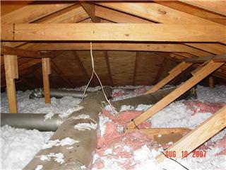

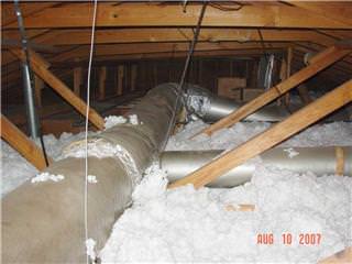

Brian G Posted August 11, 2007 Report Share Posted August 11, 2007 I just did a 70's house with a duct material I've never seen before. It was labeled: Johns-Manville Micro-Aire Type SR Air Duct Material Class 1 It was semi-rigid, like a foam, with a plastic outer jacket. The pieces were taped together on the outside, but had metal underneath at the branches. Is anybody up on this stuff? Does it have a history of problems? Image Insert: 18.17 KB Image Insert: 9.78 KB Image Insert: 15.9 KB Brian G. Another Day in the Endless Variety of Building Materials [:-crazy] Link to comment Share on other sites More sharing options...

Neal Lewis Posted August 11, 2007 Report Share Posted August 11, 2007 Brian, Is it square, or round with a dark gray jacket? The older stuff is round and the plastic jacket will split and leak a lot of air. I was at a house recently where the HVAC estimator said his company always replaces this stuff becuase of possible health concerns. I tried uploading a pic, but it is too large. Ouch. Link to comment Share on other sites More sharing options...
Brian G Posted August 12, 2007 Author Report Share Posted August 12, 2007 Mine is round. I can find all kinds of info on the flat sheets and square stuff, but nothing on the round. I didn't see any splits in the outside, but I wasn't impressed by it either. Did the guy offer any specifics about the health concerns? Brian G. It Makes My Head Hurt; Does That Count? [:-headach Link to comment Share on other sites More sharing options...
Jim Katen Posted August 12, 2007 Report Share Posted August 12, 2007 Originally posted by Brian G. Mine is round. I can find all kinds of info on the flat sheets and square stuff, but nothing on the round. I didn't see any splits in the outside, but I wasn't impressed by it either. Did the guy offer any specifics about the health concerns? Brian G. It Makes My Head Hurt; Does That Count? [:-headach It looks like regular old fiberglass duct. Some people believe that fiberglass will become the new asbestos. They've been saying this for 20 years. I don't happen to share the concern. - Jim Katen, Oregon Link to comment Share on other sites More sharing options...

Neal Lewis Posted August 12, 2007 Report Share Posted August 12, 2007 That stuff is very common around here. The guy from the big, well known A/C outfit says they always remove it for health concerns. No specific reason. The ducts tend to fall apart at the joints and the plastic outer coverings split wide open and leak tons of air. Link to comment Share on other sites More sharing options...
Inspector Will Posted August 22, 2007 Report Share Posted August 22, 2007 Brian G. I see this material quite often in homes built during the 70's. Based on the research I have done I have done including talking with HVAC contractors and competent inspectors, I refer this for further evaluation stating health concerns. The duct material is comprised almost entirely of a fiberglass wool and over time this material may deteriorate causing the fiberglass particles to become airborne. These particles may cause irritation to persons with sensitive respiratory systems. Upon googling this material, most of what you will find is new product information for Johns-Manville. I did not find an article which describes this material and states the related health concerns. The trade name does not exactly match the stuff I have come across but the physical description and manufacturer is the same. See attached link. Link to comment Share on other sites More sharing options...
Brian Kelly Posted August 22, 2007 Report Share Posted August 22, 2007 In the 90's I worked for a HVAC company who installed a large volume of this stuff. We too found that it was not the best for health reasons as more and more people are sensitive to just about everything. We had a machine that cut the flat sheets into every size and shape. We even cut it to be round, as round sometimes was easier to run and support. It us now more commonly used as a metal duct insulation. Link to comment Share on other sites More sharing options...
