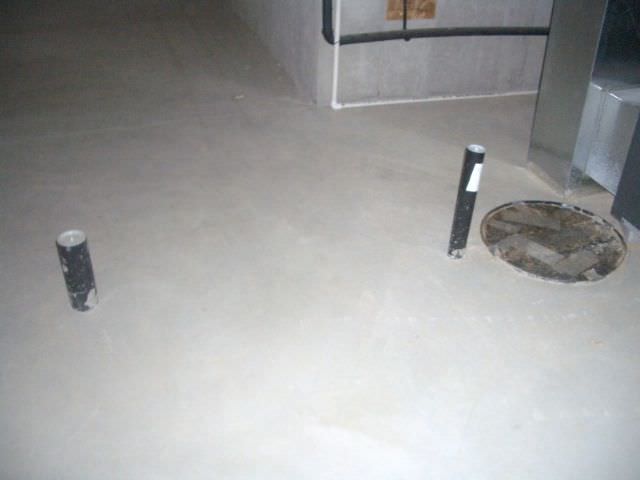

NJinspector Posted August 5, 2007 Report Share Posted August 5, 2007 New construction, these pipes are coming out of the slab. Drains for a future bath? One a drain and one a vent? What about the pit? There is another pit for the french drain? So this one.......maybe for a future ejector pump? Image Insert: 103.3 KB Link to comment Share on other sites More sharing options...
StevenT Posted August 5, 2007 Report Share Posted August 5, 2007 Originally posted by NJinspectorNew construction, these pipes are coming out of the slab. Drains for a future bath? One a drain and one a vent? What about the pit? There is another pit for the french drain? So this one.......maybe for a future ejector pump? b]Image Insert:[/b] 103.3 KB Without looking at everything else (or the plans), it's difficult to determine from the picture exactly what the plumber has in mind. Did you open the pit and look inside? is the pipe tied into the pit? I'm don't understand why there would be a separate pit for the French drains, unless it's a local thing to install two pits. If it's plumbing for a future bath, I would expect to see a floor flange or at least 4" (or 3") pipe for a floor flange. The pipe on the left appears larger than the other pipe. Is it 3"? If it is and if the pipe on the right isn't connected to the pit, I would think there are plans for a future toilet/sink in that location. Link to comment Share on other sites More sharing options...
kurt Posted August 5, 2007 Report Share Posted August 5, 2007 It's a roughed-in bath. The pipes get trimmed flush & fit w/flanges or whatever couplers are necessary, and the pit on the right is the ejector pump. Link to comment Share on other sites More sharing options...
Bain Posted August 5, 2007 Report Share Posted August 5, 2007 Except the pit appears to've been filled in. It may be there to accommodate the trap of a bathtub drain. It seems way too large, but around here builders line the--typically--square hole with treated boards and then fill the hole with gravel so no one will step into it. Link to comment Share on other sites More sharing options...
Jim Katen Posted August 6, 2007 Report Share Posted August 6, 2007 Originally posted by NJinspector New construction, these pipes are coming out of the slab. On most new construction around here, there are plans on site. Isn't that true in other parts of the country? I'd just look at the plans. If I had to guess, without plans to look at, I'd agree with Kurt. It's a very typical-looking rough-in for a basement bathroom. - Jim Katen, Oregon Link to comment Share on other sites More sharing options...
Jesse Posted August 6, 2007 Report Share Posted August 6, 2007 Like Kurt said, a roughed-in bath. Steven, there's a separate pit because your waste water (bath ejector pit) should have a different destination from your ground water (French drain). Link to comment Share on other sites More sharing options...
fqp25 Posted August 6, 2007 Report Share Posted August 6, 2007 New Construction? Is there any wall framing in the basement? If these are the only two pipes in the basement with no wall framing outlining a bathroom, it could be a floor drain which needs to be cut down, & a vent. Certainly there should be plans, or at least the builder or buyer should know if there should be a basement bath. I'm not sure about other regions, but I'm use to seeing a basement bath rough with at least 3 pipes. The closet/toilet, it's vent, and a stub-up for a lavatory. Full baths would have a square hole for the tub drain, (or another pipe for a shower) and it's respective vent. Link to comment Share on other sites More sharing options...
chicago Posted August 6, 2007 Report Share Posted August 6, 2007 In new construction the developer will sometimes just rough in the piping so the new owner has the option to spend xtra. Link to comment Share on other sites More sharing options...
