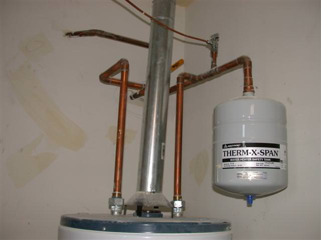

chicago Posted July 21, 2007 Report Posted July 21, 2007 I just did a condo with 50 gallon tank that had a 4.4 gallon expansion tank. From what I gather these are to keep thermal expansion from tripping the TPR valve. Does anyone know how it is determined when these are required. Image Insert: 30.32 KB
Jim Katen Posted July 21, 2007 Report Posted July 21, 2007 Originally posted by chicago I just did a condo with 50 gallon tank that had a 4.4 gallon expansion tank. From what I gather these are to keep thermal expansion from tripping the TPR valve. Does anyone know how it is determined when these are required. Generally, you use one of those things when the water service includes a pressure reducing valve. Particularly if the PRV lacks a bypass to allow excess pressure back to the street side. - Jim Katen, Oregon
chicago Posted July 21, 2007 Author Report Posted July 21, 2007 This was in the city and only a 3 story building which I believe had standard pressure with this being a duplex. Far as I could tell there was no booster, but did not gain full access.
John Dirks Jr Posted July 21, 2007 Report Posted July 21, 2007 In some areas they might be showing up in all new construction due to the 4 letter "C" word.
John Dirks Jr Posted July 21, 2007 Report Posted July 21, 2007 I see the shutoff valve handle behind the ventpipe but I cant tell is it is on the cold side like it should be. Also, since cold should be on the right, either the front of that tank is facing the wall or that expansion tank is connected to the wrong side. Shouldnt the expansion tank be on the hot side?
chicago Posted July 21, 2007 Author Report Posted July 21, 2007 Since the humidifier line is on the same side I was rethinking this.You may be right.
homnspector Posted July 21, 2007 Report Posted July 21, 2007 I see the humidifier line installed on the hot side fairly regularly, I think to reduce the evaporative cooling effect. As far as the tanks, they are on all new construction here. May be a regional thing.
John Dirks Jr Posted July 21, 2007 Report Posted July 21, 2007 The humidifier would work better with the line on the hot side. Was the thermostat facing out on that thing? if thats the case than something aint right. With the t stat/controll facing out, the cold should be on the right and the hot on the left.
chicago Posted July 21, 2007 Author Report Posted July 21, 2007 False alarm ,but thanks for the heart attack as I am wrapping up the report.LOL http://www.plumbersurplus.com/pdf/01203.pdf
Jesse Posted July 21, 2007 Report Posted July 21, 2007 Wouldn't you need an expansion tank on the cold side if there's a backflow prevention device upstream?
StevenT Posted July 21, 2007 Report Posted July 21, 2007 Any expansion tank that comes to my mind was on the cold side of boilers. I dont normally see them on hot water tanks. But if the x tank is at the cold water feed it could also accomondate both.
chicago Posted July 21, 2007 Author Report Posted July 21, 2007 Yes... read the attached PDF. It says cold side which is why I said, thanks for the heart attack. It is easy to confuse with hot water furnace expansion tanks. Glad some one gave it a thought though as They are not that common that I have seen.As far as the hot water tanks are concerned. Steve I see you posted same time. Is it boilers or furnaces.I think of boilers as steam.Hot water as furnace.

kurt Posted July 22, 2007 Report Posted July 22, 2007 Chicago now requires a tank on any new construction water heater install, and they also want to see a pan under the water heater. The city (read union) also wants a pressure pump on any water inlet <1 1/2". Of course, this being Chicago, approx. half the goofballs working don't know they're supposed to be doing this.
