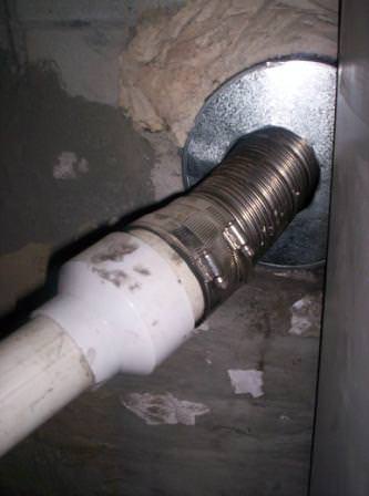

Ponyboy Posted June 29, 2007 Report Share Posted June 29, 2007 Well I just shut down a furnace today when I found the flue disconnected from the furnace. A single mom and two kids live in the house. The rust around the flue connection indicates it has been disconnected for some time. As I followed the plastic flue to the foundation it connects into a flex metal gas flue and disappears into the old oil furnace chimney liner. Note the connector is a plumbing drain connector between the plastic and metal. This is a remodeled house (2005 second story addition) where the brick chimney has been extended and enclosed in wood framing. No gas vents outside, just one for the fireplace. Of course the home owner flipped out called the contractor who had some choice words for me! Looking for some gas flue installation language so I can have a very accurate report. I was just informed the seller will have a furnace contractor at the house 8:30 AM tomorrow and they want copy of my findings about the flue. What would you say? Image Insert: 20.74 KB Image Insert: 19.36 KB Link to comment Share on other sites More sharing options...

hausdok Posted June 29, 2007 Report Share Posted June 29, 2007 Okay, It looks to me like they've fully-lined that masonry flue with that flex. Did they cap it as well and seal it so that it's essentially now a double-walled flue? If so, and the transition coupling isn't leaking, and the condensate line is clear and draining, and the condensate pump is functioning correctly, and the the flue gases are being conveyed all the way to the outside, what's the issue? It looks like a BDP (Bryant, Daylight, Payne) Plus 90 non-direct vent application. Did you look at the install instructions. I seem to recall reading something in a BDP install manual once that said, "All models chimney-friendly when an accessory vent kit is used." The question is, is that the accessory vent kit they're talking about? ONE TEAM - ONE FIGHT!!! Mike Link to comment Share on other sites More sharing options...
Jim Katen Posted June 29, 2007 Report Share Posted June 29, 2007 Originally posted by Ponyboy Well I just shut down a furnace today when I found the flue disconnected from the furnace. A single mom and two kids live in the house. The rust around the flue connection indicates it has been disconnected for some time. I don't see the disconnection in your picture. If you're trying to build a case for dangerous condition, take a picture that show that condition clearly. As I followed the plastic flue to the foundation it connects into a flex metal gas flue and disappears into the old oil furnace chimney liner. Note the connector is a plumbing drain connector between the plastic and metal. This is a remodeled house (2005 second story addition) where the brick chimney has been extended and enclosed in wood framing. No gas vents outside, just one for the fireplace. Of course the home owner flipped out called the contractor who had some choice words for me! Looking for some gas flue installation language so I can have a very accurate report. I was just informed the seller will have a furnace contractor at the house 8:30 AM tomorrow and they want copy of my findings about the flue. What would you say? This flue installation is dangerous. It can leak large amounts of carbon monoxide into the house and it might sicken or kill people. - Jim Katen, Oregon Link to comment Share on other sites More sharing options...
Ponyboy Posted June 29, 2007 Author Report Share Posted June 29, 2007 Originally posted by hausdok Okay, It looks to me like they've fully-lined that masonry flue with that flex. Did they cap it as well and seal it so that it's essentially now a double-walled flue? If so, and the transition coupling isn't leaking, and the condensate line is clear and draining, and the condensate pump is functioning correctly, and the the flue gases are being conveyed all the way to the outside, what's the issue? It looks like a BDP (Bryant, Daylight, Payne) Plus 90 non-direct vent application. Did you look at the install instructions. I seem to recall reading something in a BDP install manual once that said, "All models chimney-friendly when an accessory vent kit is used." The question is, is that the accessory vent kit they're talking about? ONE TEAM - ONE FIGHT!!! Mike I have never seen a 90 plus venting up a chimney, ever. The vent would have to go up three stories. I have also been told you can not mix different exhaust systems together which is what has occured. Also I could not find an exterior vent location for the furnace. Link to comment Share on other sites More sharing options...

Jim Katen Posted June 29, 2007 Report Share Posted June 29, 2007 Originally posted by hausdok Okay, It looks to me like they've fully-lined that masonry flue with that flex. Did they cap it as well and seal it so that it's essentially now a double-walled flue? If so, and the transition coupling isn't leaking, and the condensate line is clear and draining, and the condensate pump is functioning correctly, and the the flue gases are being conveyed all the way to the outside, what's the issue? The Cat IV exhaust gases are so cool and so moisture laden that they'll eat up that metal liner. - Jim Katen, Oregon Link to comment Share on other sites More sharing options...

hausdok Posted June 29, 2007 Report Share Posted June 29, 2007 Hi All, Well, I've got an answer from the horse's mouth, so to speak. I contacted Bryant and they referred me to their local distributor, Airefco (888-247-3326), who referred me to their on-call field representative out of Spokane. He says there's no way that this installation would be factory approved. He says there's no problem venting it up through a chimney, but that the flue has to be an "approved material," that the approved materials are listed in the installation manual, and that there isn't any metal - aluminum or stainless steel - approved as a vent material for any of their 90+ units. He doesn't recall the 'chimney friendly' sentence, so he doesn't know what they were referring to. I suppose I could dig that back out again, but why bother? Brad has the answer he needs. That should settle it for you, Brad. I asked the gentleman to stop by TIJ once in a while and set us straight about anything in the HVAC forum that we're getting wrong. Hope to see him stop in sometime. ONE TEAM - ONE FIGHT!!! Mike Link to comment Share on other sites More sharing options...

mthomas1 Posted June 24, 2008 Report Share Posted June 24, 2008 Coming a bit late to this discussion, but it's the 80% AFUE furnaces that are "chimney friendly", not the Cat IV models. Link to comment Share on other sites More sharing options...
