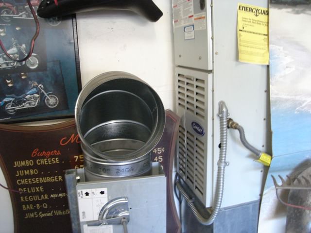

CHI Posted June 27, 2007 Report Share Posted June 27, 2007 Came across this situation yesterday. The seller works for an HVAC company. He also had a lot of nice toys in the garage, so I assume he spends a fair amount of time in there. He wanted to keep warm so he installed this 12" duct with a damper to open and close. My concern is the location of "register" to the combustion of the furnace. R309.1.2 says of garages; ducts shall be of approved materials and, "shall have no openings in the garage." Is there a problem having the register so close to combustion? Image Insert: 82.47 KB Link to comment Share on other sites More sharing options...
Kyle Kubs Posted June 28, 2007 Report Share Posted June 28, 2007 A supply register is ok close to combustion - a return register can't be within 10' of any combustion source as it can develope enough pressure to draw combustion gases out of the combustion chamber and distribute them through the house. But supply or not you can't have forced air registers in a garage. Link to comment Share on other sites More sharing options...
CHI Posted June 28, 2007 Author Report Share Posted June 28, 2007 Thanks Kyle, That was my hunch. It just looked so odd having this huge open duct near the furnace. I'll write it up as a register is not recommended in the garage. Thanks Much! Link to comment Share on other sites More sharing options...
carle3 Posted June 28, 2007 Report Share Posted June 28, 2007 This furnace looks like it is elavated the 18 inches and is an auxilary heat source for the garage and not connected to the home's heating system. So why would this supply register not be allowed? There would be no fear of fumes infiltrating back into the home with this being a seperate system. Link to comment Share on other sites More sharing options...
randynavarro Posted June 28, 2007 Report Share Posted June 28, 2007 In these parts, its most common so see furnaces in the garage. Its probably part of the home heat system. Other than the responses already provided, I'll add that the furnace probably isn't large enough to handle the additional cubic volume of the garage. Link to comment Share on other sites More sharing options...
CHI Posted June 28, 2007 Author Report Share Posted June 28, 2007 You got it Randy, this heater was used for the entire home and when you turned that damper lever you got a huge shot of air that made a difference in the amount of air flow in the interior of the home. Thanks for the input. Link to comment Share on other sites More sharing options...
Brian G Posted June 28, 2007 Report Share Posted June 28, 2007 Maybe it's just the perspective of the photo, but it looks like it seriously impairs access to the unit to me. Brian G. I Had a Girlfriend Like That Once... [:-eyebrow Link to comment Share on other sites More sharing options...
