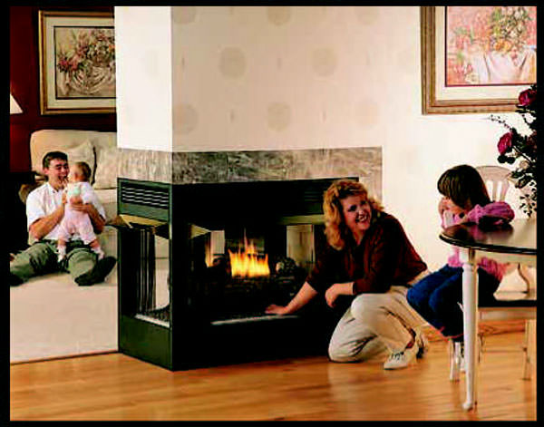

chicago Posted June 22, 2007 Report Share Posted June 22, 2007 Ouch! Image Insert: 66.96 KB Link to comment Share on other sites More sharing options...
