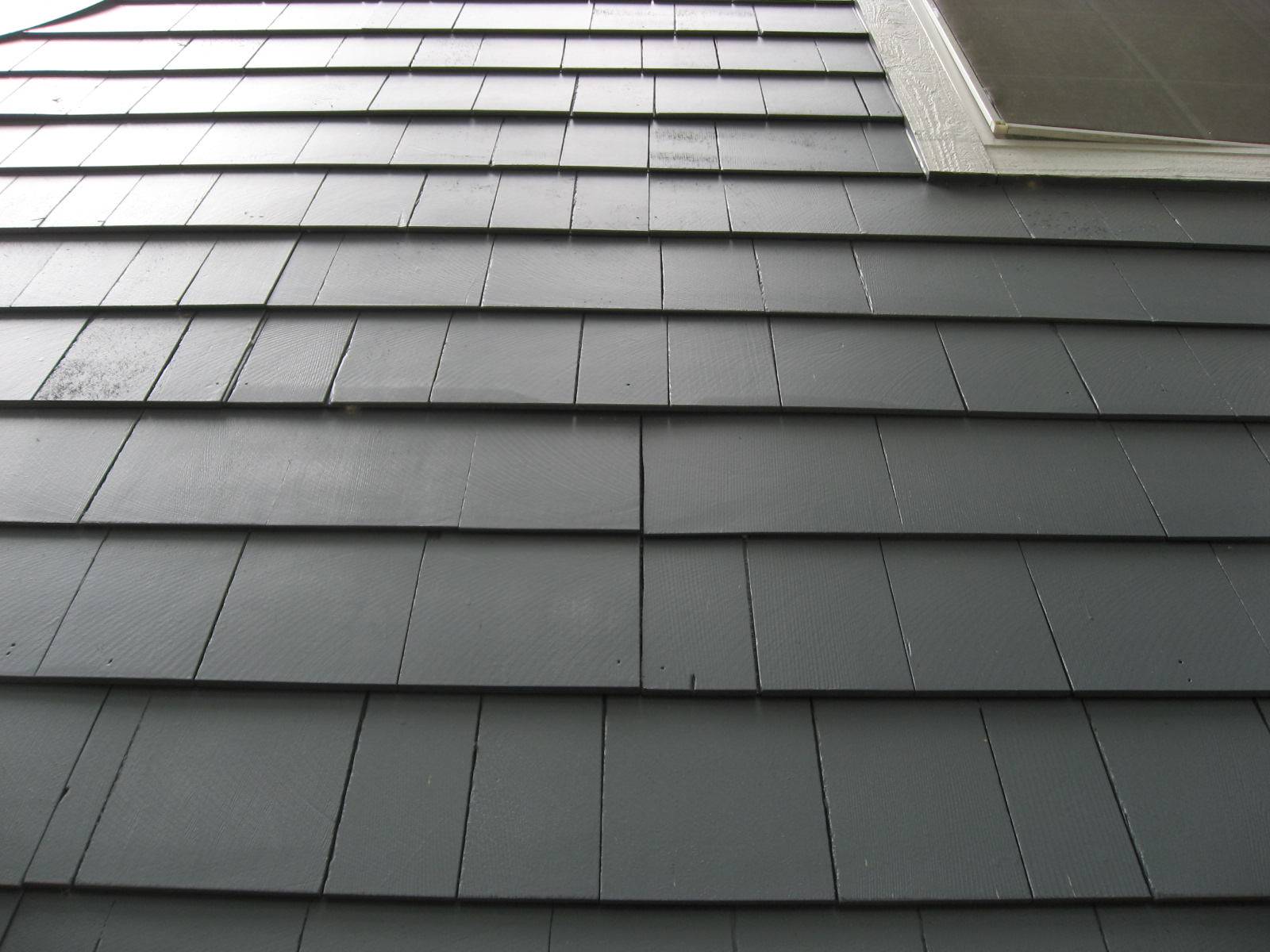

randynavarro Posted June 15, 2007 Report Share Posted June 15, 2007 Today's home was covered top to bottom with pre-fab'd cedar shingle panels. Image Insert: 419.8 KB At several spots, the keyways are lined up for three and four courses. I can't find any credible info from mfr's web sites. Is it a problem. Link to comment Share on other sites More sharing options...
Bill Kibbel Posted June 16, 2007 Report Share Posted June 16, 2007 At several spots, the keyways are lined up for three and four courses. I would guess these are multi-course panels (3-4 courses per panel) w/out overlapping, staggered end joints. The manufacturer probably specifies caulking end joints, unless this is yet another exterior wall covering product that relies solely on building paper to protect the building. Link to comment Share on other sites More sharing options...
