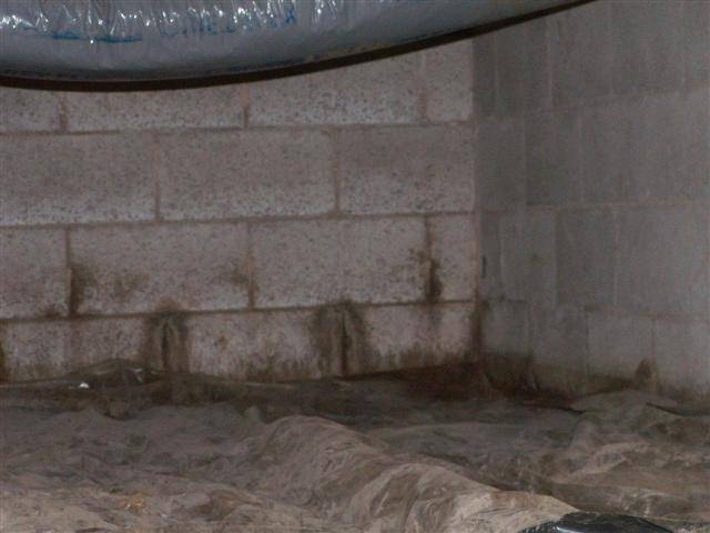

fqp25 Posted June 15, 2007 Report Share Posted June 15, 2007 Saw this today, 17 year old house. Mortar joints appear to be leaking moisture. For some reason I had always thought moisture would seep in through the block first instead of the joint. (Thinking the mortar would be more dense). The client (the buyer) was present during the inspection and had asked what could be done to stop this. Any help is greatly appreciated... Image Insert: 111.52 KB Link to comment Share on other sites More sharing options...
hausdok Posted June 15, 2007 Report Share Posted June 15, 2007 Hi, Looks like the footing drain is either occluded or they placed it too high. Either that, or the downspout receivers are broken below grade, or downspouts are dumping next to the foundation, or drainage sucks. If it's not drainage, broken receivers or misdirected downspouts, it's gotta be an occluded or improperly placed footing drain, in which case the choices are root out the drain or dig up and reinstall the footing drain at the proper height, or install a sump pump in the crawl, connect it to the footing drain and plumb it well clear of that home to the exterior, to remove that water, and install a new barrier that's secured to the walls below the plate but above the infiltration and seal it to the perimeter of the sump well and cap the well, so that there's no way any evaporation is taking place down there. If you want, I can send you a good article that will show you how to detail that crawlspace so that something like that isn't much of a concern. ONE TEAM - ONE FIGHT!!! Mike Link to comment Share on other sites More sharing options...
