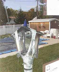

Joe Tedesco Posted May 31, 2007 Report Share Posted May 31, 2007 Wet and Damp Locations Luminaires (fixtures) installed in wet or damp locations shall be installed so that water cannot enter or accumulate in wiring compartments, lampholders, or other electrical parts. All luminaires (fixtures) installed in wet locations shall be marked, "Suitable for Wet Locations.'' All luminaires (fixtures) installed in damp locations shall be marked, "Suitable for Wet Locations'' or "Suitable for Damp Locations.'' Download Attachment: PoleLight1.jpg 34.78 KB Download Attachment: PoleLight2.jpg 31.09 KB Link to comment Share on other sites More sharing options...
