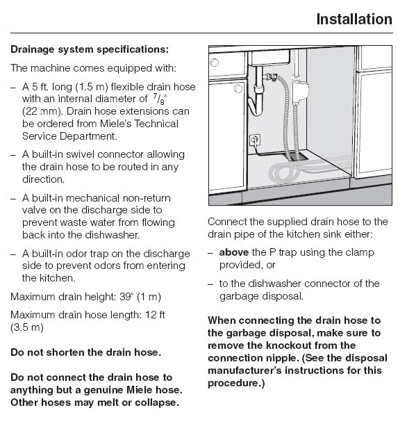

JesseWBryant Posted May 31, 2007 Report Posted May 31, 2007 Todays dishwasher did not have a sufficient "high loop" and did not have an anti-siphon device at the sink deck. However, a check valve was added to the drain line with the directional marker clearly pointing towards the disposer where it terminated. Good enough? Just curious.

Richard Moore Posted May 31, 2007 Report Posted May 31, 2007 Some, maybe all, Miele dishwashers have... "A built-in mechanical non-return valve on the discharge side to prevent waste water from flowing back into the dishwasher." Anyone know if any other brands have a built-in check valve?
Jesse Posted May 31, 2007 Report Posted May 31, 2007 Does the Miele installation guide tell you to use a high loop? Or, because of the valve, do they ignore it?

Richard Moore Posted June 10, 2007 Report Posted June 10, 2007 And to answer Jesse's question from before...here's the page from the Miele install manual. Download Attachment: mieleinstall.jpg 109.96 KB No high-loop or air-gap required. At least by the manufacturer.
