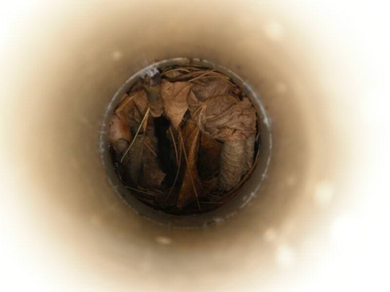

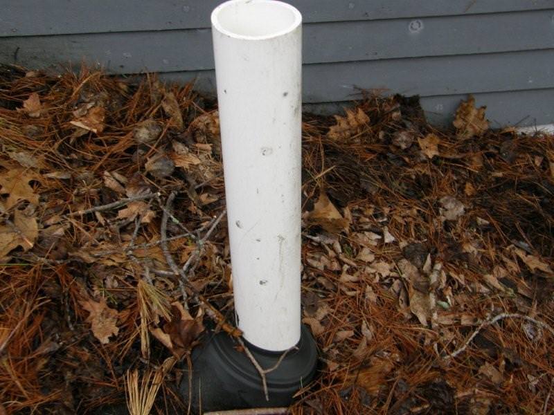

JohnC Posted May 20, 2007 Report Share Posted May 20, 2007 Just wondering how would remove leaves, pine needles and debris from a vent pipe? John Callan Download Attachment: Vent pipe.jpg 92.15 KB Download Attachment: Vent pipe debris.jpg 30.79 KB Link to comment Share on other sites More sharing options...

StevenT Posted May 20, 2007 Report Share Posted May 20, 2007 Try a shop vac with extra extensions. Just make sure you tape them or put a small screw to hold them together or your next post will be... "How do I remove a vacuum tube from a vent pipe". Link to comment Share on other sites More sharing options...
randynavarro Posted May 20, 2007 Report Share Posted May 20, 2007 Good 2nd photo. Link to comment Share on other sites More sharing options...

Kyle Kubs Posted May 22, 2007 Report Share Posted May 22, 2007 Originally posted by StevenT Try a shop vac with extra extensions. Just make sure you tape them or put a small screw to hold them together or your next post will be... "How do I remove a vacuum tube from a vent pipe". That was my first reaction as well... just befor the word "Methane" came into my mind. Better make that a shop vac with a sealed motor made for explosive environments. Probably get along with a normal one 999 times out of a 1000 but... Link to comment Share on other sites More sharing options...
