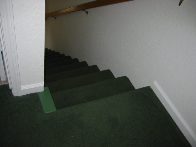

Renron Posted March 4, 2004 Report Posted March 4, 2004 Does this look acceptable to anyone? I don't think it is correct, but would like the more experienced opinions of my peers. Thank you Ron Download Attachment: 13063 Lincon wy 057.jpg 111.08 KB
Robert E Lee Posted March 4, 2004 Report Posted March 4, 2004 I believe I would have suggested a short section(8"-10")of railing at the location of that first stair tread to prevent an accidental slip off of the side of the landing. In any case I don't think it would conform to current standards. Robert E Lee
Brian G Posted March 4, 2004 Report Posted March 4, 2004 I have to agree with General Lee about the short railing, but if it were in my house I wouldn't install it. It would only pinch the access to the stairs, and my wife likes to move the furniture around occasionally. Brian G. Anybody Wanna Help Next Time? [:-irked]

RobC Posted March 4, 2004 Report Posted March 4, 2004 Unprotected opening at stairwell landing. I would choose my words carefully and include a photo in the report. Regardless of any code, I wouldn't want the conversation if a child walked off the platform and down 13.5 risers. My .745 cents
Renron Posted March 4, 2004 Author Report Posted March 4, 2004 RobC, That's exactly how I see it,------ a safety hazard. Terence, R&R ok Thanks All! Ron
allspec33351 Posted March 4, 2004 Report Posted March 4, 2004 On my Saturday inspection I had the same thing. I called it out as in need of protection. Realtor said it was permitted as in they got a permit for the second story. I also called out the the ac was not working. Realtor said that it was not working efficiently. I called out electrical panel was sealed and with cabinet in front of panel. Realtor said why would you want to get into the panel? (to see inside) I called for an engineer because of the house separating from two additions. Realtor said I was too picky. Captain

woodbyter Posted March 23, 2004 Report Posted March 23, 2004 If the general public only realized how much we try to protect them from themselves. I do not agree having a permit for the second floor would cover the missing safety feature. For one thing the permit for the second floor hopefully was "design reviewed" by the permit issuing department. Secondly most permit issuances carry a small print declaration stating the work has been reviewed and a permit issued but final approval is based on field inspection of the completed work. If the permit issuing department has already "final field inspected" the installation and passed it (which is why I have little faith in many code enforcement inspectors) I would still point it out and report it in writing. (If hauled into court as a witness I would prefer to defend my actions of reporting it than to explain why I didn't) As for the realtor's comments when did they become inspector's anyway (except when it protected their meal ticket and commission?)
