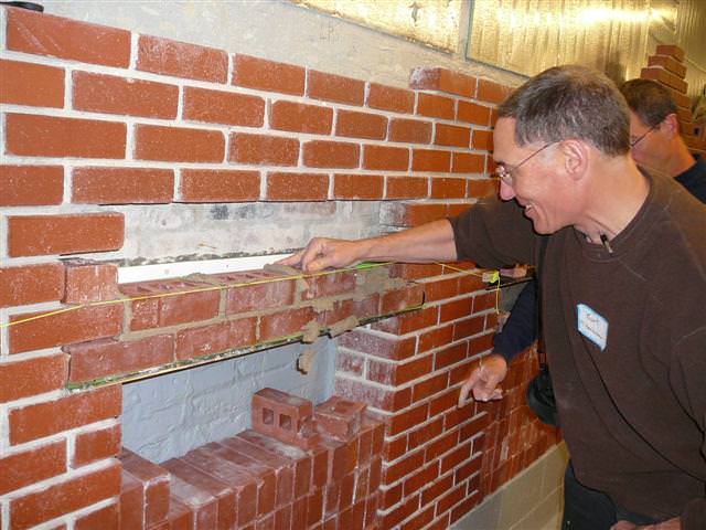

kurt Posted April 25, 2007 Report Share Posted April 25, 2007 I spent a truly informative day @ Union Local 52 on Masonry Restoration. It was put on by the IMI / International Masonry Institute. Unlike the BIA or MIA, the IMI is focused around the trade & craftworkers, i.e., the folks that do the work. We spent 2 hours in class and 4 hours hands on in the lab replacing lintels, practicing tuckpointing, learning about terra cotta restoration w/a range of new products from Edison Coatings, practicing our hand @ caulking w/industrial caulking equipment, and a fantastic slide presentation about Natural Cement, which to my embarassment, I'd never even heard of before. They've got a very nice bunch of masonry details, downloadable in .pdf format for anyone that's interested. The details can also be "played" in Media Player; very nice. http://www.imiweb.org Check out the moron getting schooled in lintel replacement..... Download Attachment: lintel replacement.JPG 72.23 KB Link to comment Share on other sites More sharing options...

Jim Katen Posted April 26, 2007 Report Share Posted April 26, 2007 Check out the moron getting schooled in lintel replacement..... Where's the flashing? -Jim Katen, Oregon Link to comment Share on other sites More sharing options...

kurt Posted April 26, 2007 Author Report Share Posted April 26, 2007 Where's the flashing? -Jim Katen, Oregon There' a tiny little line of green WRGrace showing along the front edge, and the wall connection is that shiny aluminum termination bar above the brick course I just set. We used the real stuff, peel & stick WR Grace, complete w/end dams, wicks, stainless drip shelf, etc. The jobs I see actually happen used "garbage bags", no drip shelf, no term bar, no end dams, no nothing. Link to comment Share on other sites More sharing options...

Jim Katen Posted April 27, 2007 Report Share Posted April 27, 2007 Originally posted by kurt There' a tiny little line of green WRGrace showing along the front edge, and the wall connection is that shiny aluminum termination bar above the brick course I just set. Yes, I see it. Is that also what the green color is under your wrist? We used the real stuff, peel & stick WR Grace, complete w/end dams, wicks, stainless drip shelf, etc. The jobs I see actually happen used "garbage bags", no drip shelf, no term bar, no end dams, no nothing. What is a "drip shelf"? Also, I'm interested in the opinion that these guys have about using flashing under the rowlock course beneath window openings. Around here, even masons who'll put flashing everywhere else won't do it there because the bricks loosen & fall off. - Jim Katen, Oregon Link to comment Share on other sites More sharing options...
kurt Posted April 27, 2007 Author Report Share Posted April 27, 2007 Yes, I see it. Is that also what the green color is under your wrist? Part of the that is the yellow string line; I think it's partly string, part flashing behind my wrist, part optical illusion. What is a "drip shelf"? It's a steel drip angle, set under the brick, on top of the flashing, to deflect water away from the wall. On large high rise construction, there is so much water sheeting down the wall there needs to be a break to kick it out away from the building as the volume of water can erode the mortar joints, just like a river carving the Grand Canyon. Also, I'm interested in the opinion these guys have about using flashing under the rowlock course beneath window openings. Around here, even masons who'll put flashing everywhere else won't do it there because the bricks loosen & fall off. - Jim Katen, Oregon There was a discussion about that, most of it tending toward "geez guys, try to use solid sills pitched to drain because brick sills always fall apart". I'm not sure if flashing under the rowlock course makes a big difference; they tend to fall apart regardless in my experience. Link to comment Share on other sites More sharing options...
ozofprev Posted April 27, 2007 Report Share Posted April 27, 2007 Perhaps a dumb question, but why didn't they throw some mud atop the leftmost brick on the lintel before they set it? Link to comment Share on other sites More sharing options...
