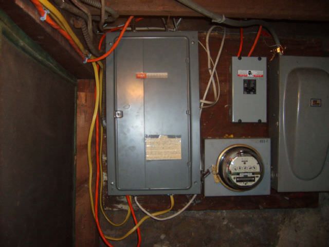

NewInspector Posted April 23, 2007 Report Share Posted April 23, 2007 Hello all, I understand all the issues regarding FP Breaker Panels (loose bus conn.'s, CB's failure to retrip, slim panel width prone to overcrowding, FP falsifying data), but I came across an older panel w/fuses & realized that I hadn't really come across anything in my readings. How should these be addressed? Aside from being outdated (by modern standards) and from FP. Thx in advance. Download Attachment: FP Panel_Fuses_1.jpg 183.74 KB Download Attachment: FP Panel_Fuses_2.jpg 155.97 KB Link to comment Share on other sites More sharing options...
allspec33351 Posted April 23, 2007 Report Share Posted April 23, 2007 That panel enclosure is a replacement for the original panel. That could be a FUBAR panel. Captain Link to comment Share on other sites More sharing options...
PAbernathy Posted April 23, 2007 Report Share Posted April 23, 2007 Sorry I do not have time to view the images right now but let me say something on the FPE Fuse Style panels.....while fuses are usually outdated in that it makes it hard to add additional circuits...fuses themselves are very reliable and ironically FPE made some good fuse panels ( except the fuse stabloks )....but the only real reported issue with FPE is in regards to the breakers and stablok design associated with it. Link to comment Share on other sites More sharing options...
Neal Lewis Posted April 23, 2007 Report Share Posted April 23, 2007 The real issue is that the insurance company is likely to require replacement of the fuses in order to issue a permanent policy. Link to comment Share on other sites More sharing options...
