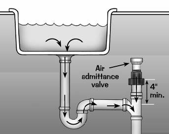

Richard Moore Posted April 4, 2007 Report Share Posted April 4, 2007 I go with... The drains under the xxxx sinks are configured as S-traps. The problem with an S-trap is that the water seal may be lost due to siphonage and sewer gas could then flow freely into the room. An inexpensive device known as an Air Admittance Valve (AAV) is now widely accepted and can solve this problem relatively easily and without tearing into the walls to install traditional venting. and include the following image... Download Attachment: AAV1.jpg 16.03 KB Link to comment Share on other sites More sharing options...
Neal Lewis Posted April 4, 2007 Report Share Posted April 4, 2007 Too bad the AAV is not allowed in NJ... Link to comment Share on other sites More sharing options...
Richard Moore Posted April 4, 2007 Report Share Posted April 4, 2007 Originally posted by Neal Lewis Too bad the AAV is not allowed in NJ... Blame the plumbers unions. They hate the simpler fixes they can't charge an arm and two legs for. Link to comment Share on other sites More sharing options...

StevenT Posted April 12, 2007 Report Share Posted April 12, 2007 AAV's ("pro-vents") are not allowed in NY either. I'm not sure if it's because of the Plumber's Union or because they are usually buried in walls and when they eventually fail, it is the same as having an open sewer system. From time to time, I ... let's say, have seen them. Always try to keep the accessible. Link to comment Share on other sites More sharing options...
ozofprev Posted April 12, 2007 Report Share Posted April 12, 2007 Steve, That used to be true, but NYS does in fact now allow AAVs. It's possible that a local municipality is fighting against them, but NYS allows AAV's. They must be accessible, and must be 4-6 inches above the trap. Originally posted by StevenT AAV's ("pro-vents") are not allowed in NY either. I'm not sure if it's because of the Plumber's Union or because they are usually buried in walls and when they eventually fail, it is the same as having an open sewer system. From time to time, I ... let's say, have seen them. Always try to keep the accessible. Link to comment Share on other sites More sharing options...
Chad Fabry Posted April 12, 2007 Report Share Posted April 12, 2007 They must be accessible, and must be 4-6 inches above the trap. ...above the weir of the trap. I have to take these opportunities as they arise. Link to comment Share on other sites More sharing options...
ozofprev Posted April 12, 2007 Report Share Posted April 12, 2007 Above the top of the weir of the trap.[:-magnify There's a wart on the frog on the log.... Originally posted by Chad Fabry ...above the weir of the trap. I have to take these opportunities as they arise. Link to comment Share on other sites More sharing options...
