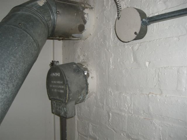

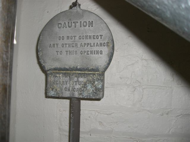

Bradd Judd Posted March 22, 2007 Report Share Posted March 22, 2007 Can someone tell me what the heck this is??? I have saved this in my photo folder from a 100 inspections ago, and I keep seeing this damn photo again and again. Heck I don't even remember what type of building or the year it was built, but I'm pretty sure it was in Chicago....Elmwood Park maybe? Thanks guys, Brad Download Attachment: whatisthis.JPG 45.65 KB Download Attachment: this.JPG 46.36 KB Link to comment Share on other sites More sharing options...
Les Posted March 22, 2007 Report Share Posted March 22, 2007 Clean-out Link to comment Share on other sites More sharing options...
mthomas1 Posted March 22, 2007 Report Share Posted March 22, 2007 That shrouded opening at the bottom (second pic) makes we wonder if it's some sort of draft inducer. Link to comment Share on other sites More sharing options...
kurt Posted March 22, 2007 Report Share Posted March 22, 2007 What Les said. They're everywhere in Chicago. My folklore source said they're an anachronism that goes back to coal fired equipment (which was everything in Chicago). Supposedly, coal would have some nasty deposits, and condensate would run black nasty goo back down the flue. Usually, they have a little pipe (like the one in your pic) that runs down to, and through, the bsmt. floor; the goo would supposedly run down under the bsmt. floor. I've got some support for that; my house had one, and when I tore out the bsmt. floor under it, there was blackish hard crud in the dirt under the bsmt. floor slab. Link to comment Share on other sites More sharing options...

Bill Kibbel Posted March 23, 2007 Report Share Posted March 23, 2007 Supposedly, coal would have some nasty deposits, and condensate would run black nasty goo back down the flue. I guess that would make sense, if your burning bituminous (soft) coal or worse. I've never seen it here, and I've looked at thousands of chimneys that were used for venting coalcat one time. We have real coal (anthracite) here that doesn't seem to have "nasty goo" byproducts. Link to comment Share on other sites More sharing options...
