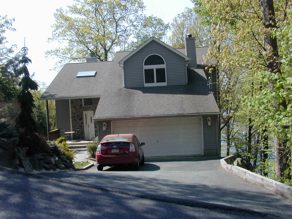

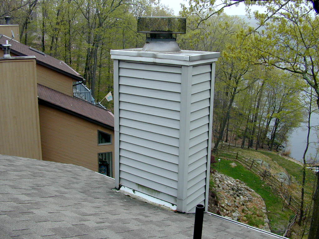

I've this one instance of it. Not from a window per say, but from a skylight. At the time, I was standing there a little perplexed wondering how some lunatic hoisted a BBQ up on that roof and why[:-bigmout. ( I had no idea what caused it, till I came home and got on TIJ, and of course, almost instantly found a recent post about warped siding that edumacated me) So, I didn't collect much information, but you can see from the house picture in the second pic that the skylight on the left, was reflecting to the wall to it's right. The skylight was "flat" glass and fairly large, so I wouldn't be surprised if gravity was having it's way & making that glass a little concave. Three years ago, but if I recall correctly, it was low E coated, though, not sure. The color of the siding was a light gray. The third pic is there just to show the color a little better. This was in North/West New Jersey.

I think we need a picture of that. [Please]

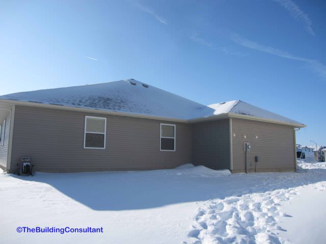

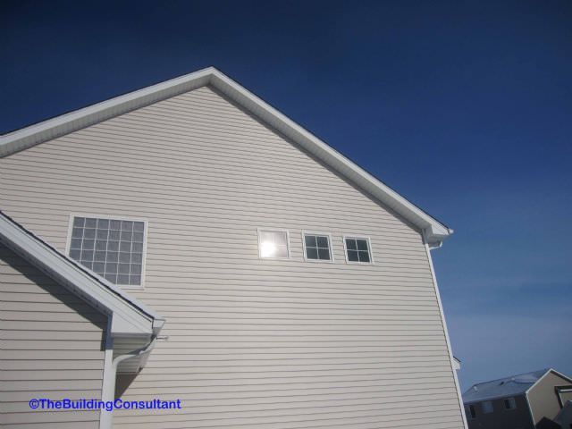

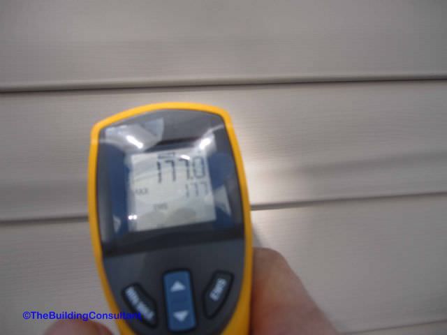

Here are a few pictures
This was taken on a 10 degree day.
The vinyl measured from 177 to 200 degrees from a window reflection that was 39 feet away.
Vinyl will thermally distort at about 165 degrees
