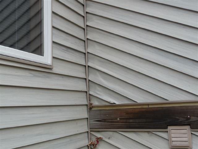

gtblum Posted November 20, 2009 Report Posted November 20, 2009 Looks like I may have run into this yesterday. The window faces dead south. The strange thing was, the place is surrounded by mature hardwoods that looked to be close enough to shade the house from the sun even in July. I can't imagine that dryer vent could throw enough heat to cause this. What do you guys think? Click to Enlarge 44.16 KB Click to Enlarge 58.67 KB
Chad Fabry Posted November 20, 2009 Report Posted November 20, 2009 What do you guys think? I think the home will easily qualify for membership in that elite group known as the "Ugliest Homes In America the world. Most of the siding that I see that looks like that is the result of stupid+grill or beer+grill.
hausdok Posted November 20, 2009 Report Posted November 20, 2009 To me, the damage looks like it's too close in to that inside corner to have been caused by refracted sunlight from either window. I think the dryer could have done it. Look at the pattern of the dark heat stain on that piece of unfinished trim and look at the direction that it goes - up and to the left. Is it possible that dryer duct outlet isn't installed very well and a bunch of that hot air is flowing up behind the siding to that corner? Some testing that CPSC did in the beginning of the decade found that dryer exhaust can be anywhere from 61 to 79°C and that the heater box of a gas dryer can exceed 800°C. I don't thnk that there's any doubt that if the air from a clothes dryer was wafting into that corner it could melt and distort that vinyl. On a side note; what kind of numbnuts installed a rain screen product on the diagonal like that. Find out, go into Word, print out a bogus Darwin Award certificate for him/her and drop it in the mail to the moron. ONE TEAM - ONE FIGHT!!! Mike

Erby Posted November 20, 2009 Report Posted November 20, 2009 To me, the damage looks like it's too close in to that inside corner to have been caused by refracted sunlight from either window. I disagree, Mike. Look at the pictures I posted on Page Three of the thread (#75). Exact same setup south facing window late afternoon sun melting the vinyl It is an UGLY house isn't it. Speaking of grill melt! see below from just yesterday. Click to Enlarge 44.54 KB-

Brandon Whitmore Posted November 21, 2009 Report Posted November 21, 2009 I can't imagine that dryer vent could throw enough heat to cause this. What do you guys think? Was there ever a deck attached to that ledger? Could be that there was a mini BBQ placed up against that area before it cooled down, ofr there could have been reflection off of something on the deck that no longer exists.
gtblum Posted November 21, 2009 Report Posted November 21, 2009 I can't imagine that dryer vent could throw enough heat to cause this. What do you guys think? Was there ever a deck attached to that ledger? Could be that there was a mini BBQ placed up against that area before it cooled down, ofr there could have been reflection off of something on the deck that no longer exists. No sir. There's a slider to the right of that corner that leads to a library/den that is so far away from the kitchen and the gigantic deck outside of it, that if there had been one, it would be an unlikley place for a grill. It's located around the right corner of where the chimney is in the last picture.
