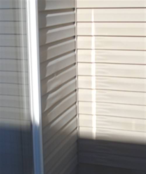

joepa Posted January 24, 2008 Report Posted January 24, 2008 Here are 3 pix I have taken of damage. I have a few more if interested. You can see the reflected sun that is causing the damage. Image Insert: 467.91 KB Image Insert: 457.76 KB Image Insert: 488.16 KB
hausdok Posted January 25, 2008 Report Posted January 25, 2008 Hi, That proves what I was saying above. With my situation, I get the same reflected pattern except that the arcs cross each other and aren't focused as intensely as that bright diamond you have in the center. You should contact Martin Holladay at Energy Design Update, he'd be tickled pink to be able to get actual photos of sunlight striking the vinyl exactly where the damage is occurring. OT - OF!!! M.

jaimemason Posted April 6, 2008 Report Posted April 6, 2008 Originally posted by joepa Here are 3 pix I have taken of damage. I have a few more if interested. You can see the reflected sun that is causing the damage. Image Insert: 467.91 KB Image Insert: 457.76 KB Image Insert: 488.16 KB
jaimemason Posted April 6, 2008 Report Posted April 6, 2008 Originally posted by joepa Here are 3 pix I have taken of damage. I have a few more if interested. You can see the reflected sun that is causing the damage. Image Insert: 467.91 KB Image Insert: 457.76 KB Image Insert: 488.16 KB I am not sure If Ii am posting right or now... I normally don't do this, but I have been doing some research myself on melting siding and I came across your posts... We had just recently finished a second story addition to our home and had the whole house resided with Certain Teed vinyl Carolina Bead siding... It is the exact color and style as Joes. My garage side of my house has totally melted and looks exactly like your photos... I have all over the place with Certain Teed and have not gotten much accomplished... I did not belive that my neighbors one little up stairs window could have done so much damage, but then when I was out there today I saw that crazy X with the almost laser looking center... In deed the siding was hot to touch... this is sooo nuts... Joe what have you done???? If the window is replaced do you think it would solve the problem? I am going to call the manufactor of the window on Monday and see what they say as I find it hard to believe that this is going to have to be my problem... Either the window must have a problem or the siding must be of poor quality... Needless to say that is kind of what Certain Teed referred to us in not so many words... They offered to replace that side of the house, but now that I see that there really is a problem with the window I think that may be useless... any way instead of rambeling I am just wondering if you have figured anything out with your home. thanks...
hausdok Posted April 6, 2008 Report Posted April 6, 2008 Hi, That's a perfect example of what I'm talking about. Mine is very similar except there is a slight dark spot in the center because it isn't perfectly focused and that prevents the temperature from getting hot enough to actually melt the vinyl. OT - OF!!! M.
Jim Katen Posted April 6, 2008 Report Posted April 6, 2008 Originally posted by jaimemason . . . If the window is replaced do you think it would solve the problem? Possibly. Can you tell if the surface of the neighbor's window is concave? It's just a guess, but I suspect that a flat piece of glass wouldn't do this. I am going to call the manufactor of the window on Monday and see what they say as I find it hard to believe that this is going to have to be my problem... Trust me when I tell you that trying to assign blame here is a worthless pursuit that will end badly. Focus on solutions, not indignation. Either the window must have a problem or the siding must be of poor quality... What's happened is the result of commonplace physical laws of nature. The sunlight hits the window; the window focuses the sunlight; the focused sunlight hits the vinyl; the vinyl gets hot; the vinyl melts. None of it has anything to do with the quality of the window or the siding. It's an unlucky accident. To correct it, you'll have to address one of the links in the chain that caused it. 1. Maybe, if the neighbor changes the glass panel in his window, the new glass will be flat and won't focus the light so strongly. This is a dicey one because, the glass shape can change over time. 2. Is there a way to build a fence that will shield your siding from the window's reflected light? 3. The existing vinyl is toast anyway. Could you re-side that side of your house with Hardiplank and paint it to match the vinyl? 4. You could go to the hardware store and buy some aluminum and some bronze screen material. When the light is hitting your house, place one of those screens over the neighbor's house to see what effect it has. - Jim Katen, Oregon

Erby Posted October 30, 2008 Report Posted October 30, 2008 I've seen quite a bit of melted siding due to window reflection but today I actually got to see the reflected light. The siding temperature at the light spot was about 115 degrees with the rest of it at about 100 degrees. The outside temperature was about 58 degrees at the time. It was a cool afternoon but the wall was facing directly west into the sun, i.e, the sun was almost directly to the left of the house as seen from the first picture. The sliding glass door was on the south wall of the house. I doubt that it was doing much melting today but it was easy to see how the reflected light moving across the wall at just the right angle would cause it during higher temperature periods. When I slid the screen part of the door open to cover the reflecting glass, the bright light went completely away. When I moved the screen out of the way, the light came back. Image Insert: 147.44 KB Image Insert: 135.03 KB Image Insert: 23.02 KB I won't say much here about the rest of the crappy installation of the siding. It's obvious! -
