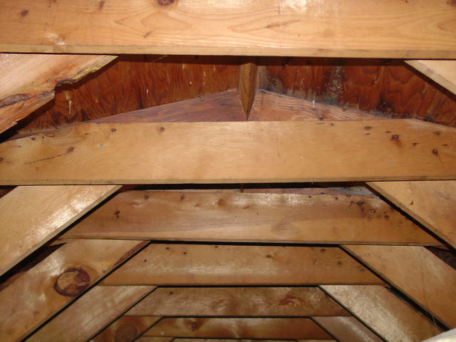

BADAIR Posted February 21, 2007 Author Report Share Posted February 21, 2007 Les, I bet you asked yourself the same question I did. Why? The rest of yous guys, I don't want to here squat about Picasso, Pei, or Dali. OK bring it on. I love criticism, ask my wife. Download Attachment: sleeper roof.jpg 262.83 KB Link to comment Share on other sites More sharing options...

Jim Katen Posted February 22, 2007 Report Share Posted February 22, 2007 Originally posted by BADAIR Les, I bet you asked yourself the same question I did. Why? The rest of yous guys, I don't want to here squat about Picasso, Pei, or Dali. OK bring it on. I love criticism, ask my wife. My best guess is that someone wanted to squeeze out a few more inches of headroom on the inner side of that kneewall. - Jim Katen, Oregon Link to comment Share on other sites More sharing options...
inspector57 Posted February 22, 2007 Report Share Posted February 22, 2007 Barry, no help on the name, but as to the reason, that makes me think of the chopped up roof lines typical in 70's houses around here that would have been open to the air where the sleepers are in your diagram, making the knee wall really the outside wall of the house. Maybe they closed it in during a remodel. In which case the technical name for the architectural element would be "Billy-Bob's sleeper system";) Just a thought. Jim Link to comment Share on other sites More sharing options...
